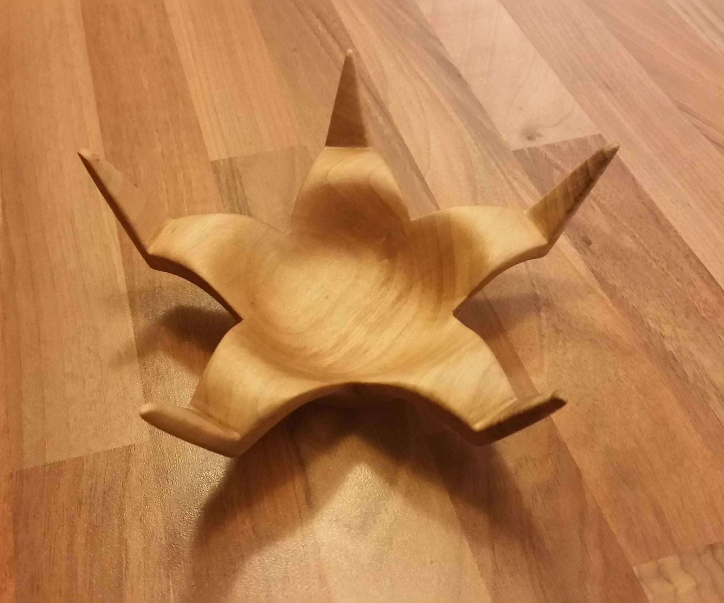

This bowl is titled experimental since I've taken on a type of woodturning I've never done before. Yet I documented the process enough to be sure I could pass on to you, the reader, enough insight for you to make one of your own!
This bowl is made by turning a whole piece of log on its side, and this presents the woodturner with many obstacles to overcome, starting with the mounting of the log to the lathe, and ending with the fact that the bowl will present two large knots (which are the center of the log, a part of the wood we try to avoid mostly in woodturning for its tendency to crack while drying), with a few more surprises between those.

And the bowl is done! I hope you didn't nick your fingers or hand on the spinning bowl wings, as that happens a lot, and if you had any "special" feature survive the turning (note the "sting" I had created from a branch that was luckily situationed in my log), consider yourself lucky, as those add a lot of character to the bowl.
Mind you I lost small pieces of bark turning this bowl. This is mostly avoided by applying a bead of CA along the border of the bark and wood all around the bowl, but since I didn't do this step in this project, it is not shown. Just be mindful of that technique and use it when needed.
