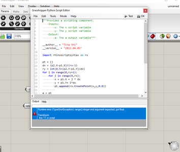

Step 1: Connecting Inputs in Grasshopper
Started out by trying to connect Rhino points and integer slider as input into Grasshopper. Apparently input from integer sliders' type hint has to be explicitly set to integer in order for Python component to treat the input as an integer. Otherwise, we can get errors like these where range() doesn't like the input because the program considers it to be a float.

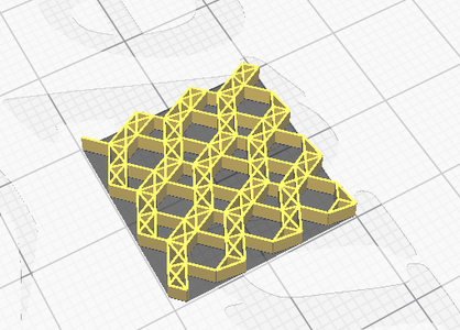

Step 5: Slicing
Exported the pattern as an .stl and sliced it in Ultimaker Cura. It seems like the design is way too tiny so went back into Rhino, undid the bake, and moved the original input points to cover a larger area.
