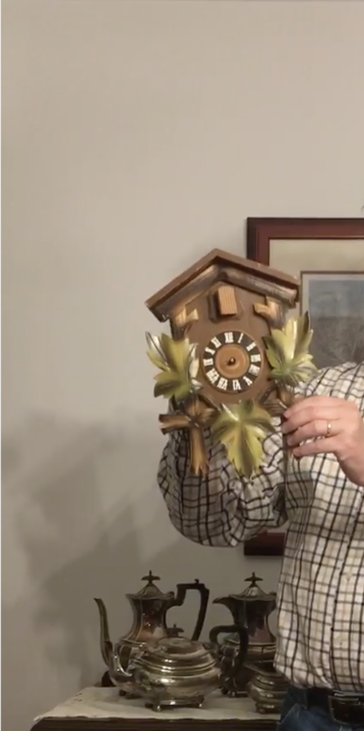

I was lucky to find a non-working cuckoo clock at a thrift store. One of the most important parts was still there; the bird whistles. I took the front off of the clock housing, tied a Slinky Junior to the clock front and the clock housing. Yeah, that'll work.
Did you know that there are bellows that blow air into the whistles? I always guessed it was some kind of friction mechanism, like a cricket!

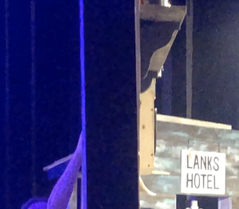

Step 2: (Required) Test on Stage
Can you see the clock on the set? Yeah, no. Too small. Important lesson here; make sure your prop fits the scale of your stage sets.

We had two members of the stage crew operate the exploding cuckoo clock. Since they were behind the wall, they used audio cues. The first stage crew member was responsible for blowing into two bird whistles (she was a flute player, so very competent). The second stage crew member was responsible for moving the bird out and in, while coordinating with the bird whistler. Then, the second stage crew member hit the exploding clock trigger knob as soon as the gun shot was heard. This was highly coordinated, and well rehearsed.
