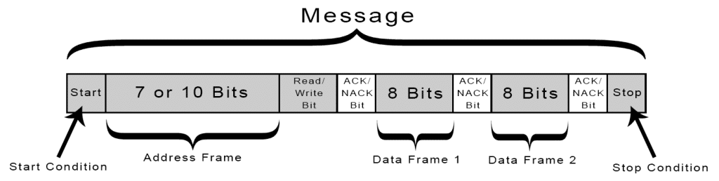

In I2C communication, data is transmitted in messages, which are composed of data frames. Each message consists of an address frame containing the binary address of the slave and one or more data frames containing the transmitted data. Additionally, the message includes start and stop conditions, read/write bits, and ACK/NACK bits between each data frame:
  • Start Condition: The SDA line transitions from a high voltage level to a low voltage level before the SCL line transitions from high to low.
  • Stop Condition: The SDA line transitions from a low voltage level to a high voltage level after the SCL line transitions from low to high.
  • Address Frame: A 7 or 10-bit sequence unique to each slave, identifying it when the master intends to communicate.
  • Read/Write Bit: A single bit indicating whether the master is sending data to the slave (low voltage level) or requesting data from it (high voltage level).
  • ACK/NACK Bit: Each frame in a message is followed by an acknowledgment or no-acknowledge bit. An ACK bit is returned to the sender if the address frame or data frame was successfully received by the receiving device.

Once the master detects the ACK bit from the slave, the first data frame is ready to be sent. Each data frame is 8 bits long and transmitted with the most significant bit first. Following each data frame is an ACK/NACK bit to confirm successful reception. The master or slave, depending on who is sending the data, must receive the ACK bit before sending the next data frame.
Upon transmitting all data frames, the master can send a stop condition to halt the transmission. This stop condition involves a transition from low to high voltage on the SDA line after a low to high transition on the SCL line, with the SCL line remaining high.

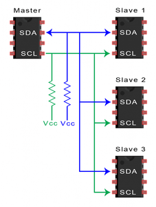

Step 4: Single Master With Multiple Slaves
Due to I2C’s use of addressing, it allows for the control of multiple slaves from a single master. With a 7-bit address, there are 128 (2^7) unique addresses available. Although uncommon, using 10-bit addresses provides 1,024 (2^10) unique addresses. To connect multiple slaves to a single master, wire them as depicted below, with 4.7K Ohm pull-up resistors connecting the SDA and SCL lines to Vcc.
