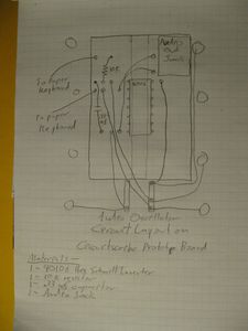

In a previous project I created a prototyping board for the Circuitscribe circuit building kit. Here I'll use it with the Circuitscribe developer boards and a simple DIY keyboard to explore some basic sound synthesis circuit concepts. I'll show how to create a simple audio oscillator with a 40106 Hex Schmitt Inverter chip and two additional components on the prototyping board. I'll use the Circuitscribe's blinker board to create two separate audio effects- a low frequency oscillator and a gate. I'll also demonstrate the use of a potentiometer to control the pitch of the audio oscillators output and then I'll create a simple DIY resistor ladder keyboard with conductive ink.
Step 1: Building the Oscillator Circuit on the Prototyping Board
In this project we'll use the Circuitscribe prototyping board to create a simple inverter based audio oscillator, and control it with elements from the Circuitscribe kits. The CD40106 Hex Schmitt Inverter is an awesome chip for the new electronics student. It features six separate inverters. An inverter is a digital logic gate. It detects if the input is high (on) or low (off). If the inverter detects a high input signal it produces a low output. If it detects a low input it gives a high output. It inverts the state of the signal. By adding a capacitor and a resistor to the inverter, it can be made to oscillate, or turn high and low over and over again.
The time it takes to turn on and off is called the rate and is determined by the values of the capacitor and resistor used. Each pulse, or on/off cycle, will produce an audible click if the output is fed to an amplifier and speaker. At very high rates the oscillator circuit produces audible sound. As the rate gets faster, the clicks get closer and closer until they produce a buzz that becomes a tone. At these speeds rate is called frequency. We perceive differences in frequency as musical notes. In the audible range frequency is called pitch. Middle C, the center note on a piano, has a frequency of 261.625565 hertz. Hertz is the unit used to measure frequency and represents the number of pulses per second. This means that an oscillator has to turn off and on 261 times each second to produce a Middle C. By changing the resistance in the oscillator circuit it is possible to create varying pitches over time, or as professional scientific types call it, 'music'.
See the pics above for details and study the circuit diagram to see how the inverter based oscillator works, then go on to the next step to see how to control the oscillator with the Circuitscribe components.

The first step was to determine the layout and trace the contact points with the template from the kit. This makes aligning the components easy. See the above pics for a step-by-step description of the circuit. I designed it to work without the blinker board at first to make it easier to determine the capacitor and baseline resistor values. When it was time to include the blinker I simply cut the drawn line with a hobby knife.
