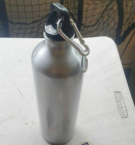

Step 1: Attaching TEG
A Thermoelectric Generation chip (TEG) chip uses the flow of heat from one of its sides to the other to create electricity. Heating one side can be done by placing the chip on a heat source such as frying pan. The other side needs a heat sink to make it cooler than the hot side. Attaching the TEG chip on the bottom of an aluminum bottle filled with cold water should make for a good heat sink.
  1. Heat paste adhesive was used to fix the TEG to the bottom of an aluminum water bottle.
  2. An aluminum disk was cut from an empty aluminum can and glued on top of the TEG using heat paste adhesive.
  3. The fan which came with the TEG was attached to the bottle using some black tape. How fast it rotates will indicate how much power is being made.

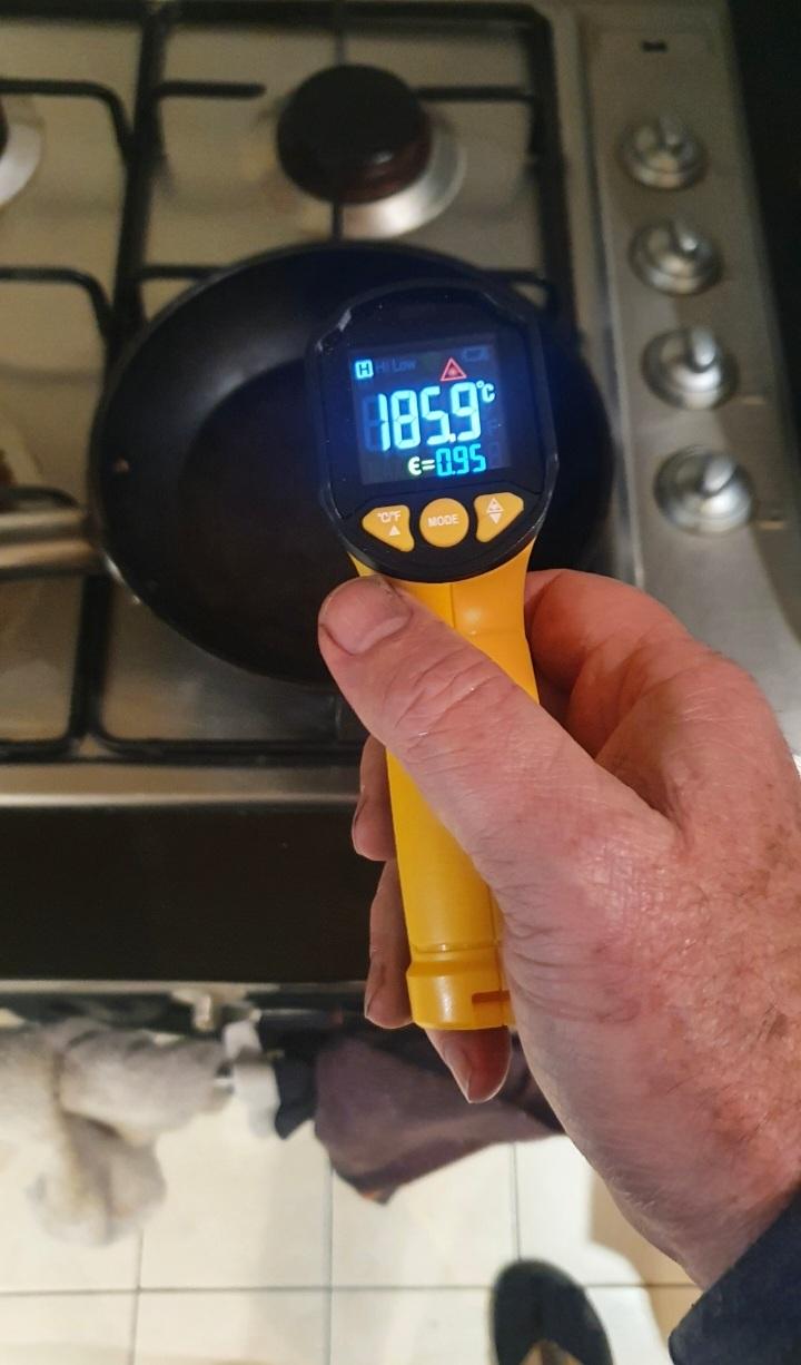

Kitchen Stove:
A frypan was placed on my kitchen stove and the heat measured using the thermometer gun. I could vary the heat by turning the gas up or down and it was constant. An ideal heat source for testing the TEG module.

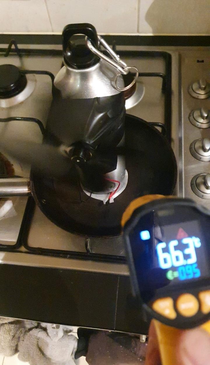

The aluminum water bottle with attached TEG was filled with cold water and placed on the frypan. When the temperature reached 185c the fan was spinning very fast and moving some air, unfortunately it stopped after only a couple of seconds. Myhypothesis being the water in the bottle immediately next to the bottom of the aluminum bottle had heated up and so it was no longer acting as a heat sink which in turn meant there was no longer heat flow within theTEG.
Fresh tap water was put into the bottle and placed on the frying pan. The stove ring was set to its lowest heat setting. It was observed:

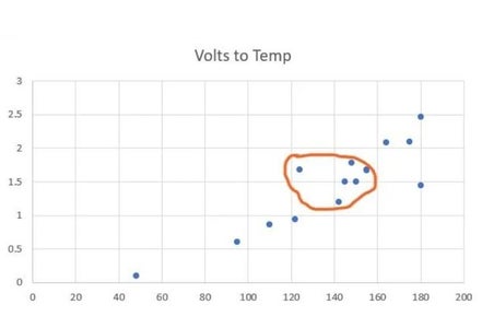

  1. The fan would just start to spin at 0.3Volts when the pan had reached 60c.
  2. An attached garden light LED required 0.7 volts to come on, this was achieved at a temperature of 110c.
  3. After about 30 seconds the light went out, after shaking the bottle of water (to mix the water) the light came back on.
  4. At a temperature of 120c, the TEG produced 0.9 volts, however the cold side appeared to warm up quite quickly as the TEG stopped working after a few seconds.
  5. After 20min of experimenting, the water in the water in the bottle was measured to be 40c.
If the hot side is at 110c and the water in the bottle is 40c, this means the TEG need a 70c temperature difference between hot side and cold side to generate enough to power the garden light LED and fan.

As the TEG works by the temperature difference between its two sides, performance can be improved by making the cold side colder using iced water. A jug of water was placed in the freezer for an hour and a half until it started to freeze, the water was then poured into the aluminum bottle. The base of the bottle was then placed on a frying pan heated to 180c. The fan spun very well and was also able to light a garden light LED (which contains a voltage booster). I measured the power generate at the temperature of 180c, to be over 2 volts, and about 200mA. But it only ran for about 40 seconds before stopping.
Press for a good fit:
I applied some downward pressure on the bottle to make a good connection between it and the TEG. The fan began to spin again. The previously applied heat paste had come away, so pressure was required to ensure a good connection for heat transfer.
The temperature was eased back to 135c. At1 volt both the fan and LED ran well. The fan was removed and the LED shone brighter. The volts also increased. With the fan and LED removed the (non-load) reading was 2 volts. This is a reminder that just taking a volt reading when no work is being done can overestimate the power being generated.

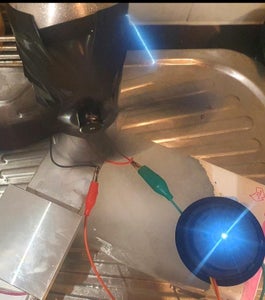

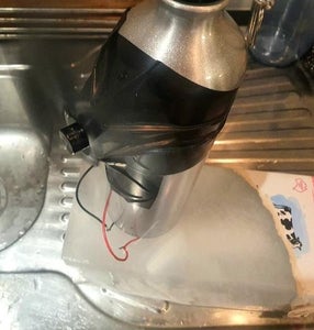

As it is the temperature difference between the two sides of the TEG which makes the electricity, I experimented by making the cold side constantly cold by using a block of ice. Ice is a great constant cold source as it won't increase in temperature above 0c.
I placed the base of the bottle on a block of ice for the cold source, for the heat source I filled up the aluminum bottle filled with boiling water. The fan turned. I measured the voltage generated to be about 1.5 volts and Amps at 150mA. The advantage of focusing on the cold source for the heat differential is the TEG won't overheat. 15 minutes past before the fan and garden light stopped.
