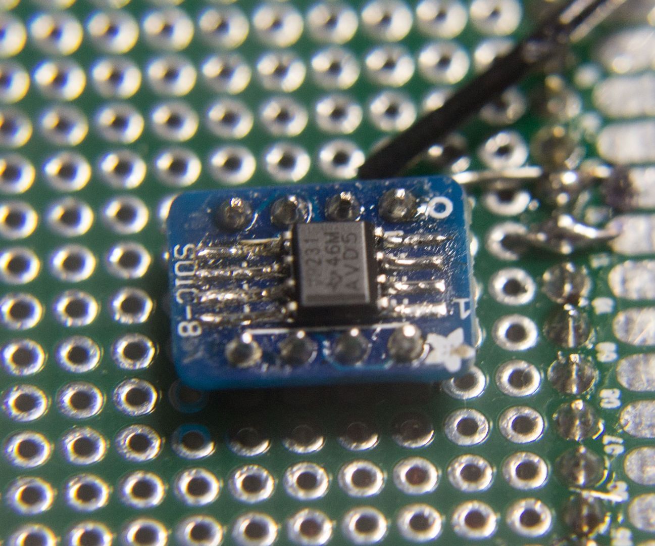

After insuring I got the right port, I then hooked up the Beaglebone black with my homebrew CAN transceiver cape (see my other instructable for more details on how to make that)
Before you start the CAN interface you will have to enable the device tree overlay for it, since my simple cape doesn’t have EPROM to pass the Beaglebone any settings. For details on that please see this tutorial.
To start the CAN interface and set the communication speed, type the following commands
ip link set can0 type can bitrate 500000 listen-only on ifconfig can0 up
The first sets your CAN interface as can0 and your transmission rate at 500Kb/s, the second brings it online.
