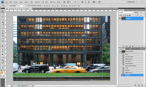

Step 1: Transform
First you want to transform the photograph to get all of the edges set up on an orthogonal system.
a. Lens Correction: Go to Filter>Distort>Lens Correction
b. Use the Vertical and Horizontal Perspective sliders to adjust and align edges with the grid. Not everything may not align so there is another option to use after the Lens Correction tool
c. Free Transform: Hold CTRL A to select the whole photograph, the hold CTRL T to enter Free Transform, then right click and select skew
d. You can set up guides by going to view>Rulers and click and drag off of the ruler to bring down guide lines.
e. Adjust the image as needed and then hit enter

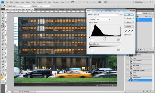

Step 2: Levels
The next step is to play with the Levels of the photograph to adjust brightness and contrast
a. Go to Image>adjustments>Levels
b. Slide the black tab right, and the white tab left until you see desired results in brightness and contrast.

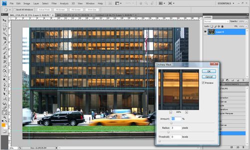

Step 3: Sharpen
After you play with the Levels you will want to sharpen the photograph to make it more crisp.
a. Unsharp Mask: Go to filter>Sharpen>Unsharp Mask
b. A good setting to use is to have it around 30% or 40% amount and a radius of 3.0. I would not increase these values too much; the photo will start to lose its quality.

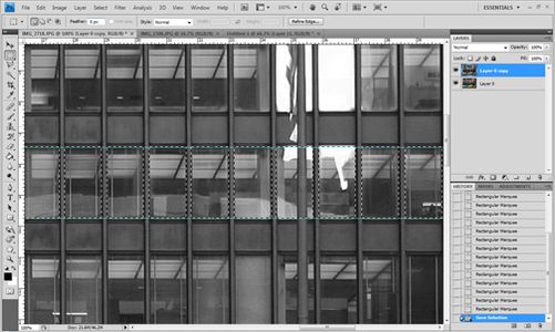

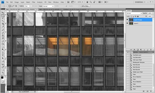

Step 6: Reveal Orange
Now that I have a top layer in b&w and a bottom layer in color, I can selectively cut way portions of the top layer so that I can start to reveal the orange in the bottom layer.
a. One way I can do this is to use the rectangular marquee tool, select a window and use this to delete the selection from the b&w layer.
b. To make the process go faster, set up guides to lock the selections to, and after making the first selection, hold the CTRL key to add to that selection.

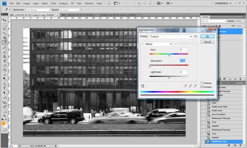

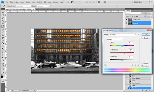

Step 7: Enriching the Orange
After revealing the Orange, I can enrich the color by selecting on the bottom layer and adjusting the Hue/Saturation.
