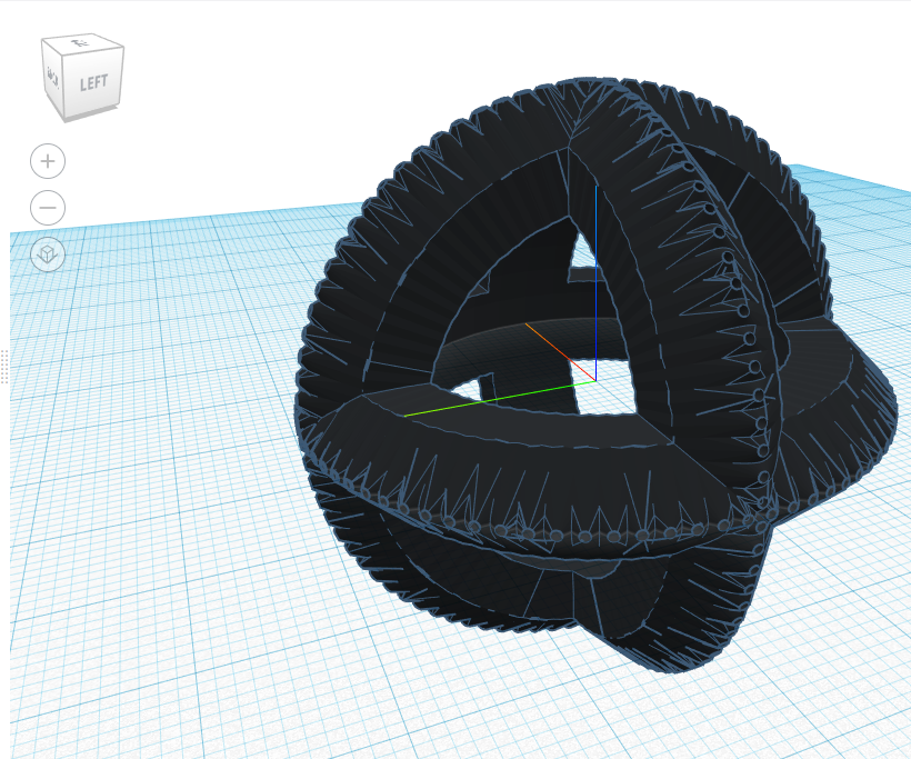

Step 2: Creating the 3 Dimensional Platforms
The Three-dimensional layers consist completely of Cylinders, a sphere hole and grouping
Start by creating a New Object
- Add a count with loop set as, count with (any) from 1 to #oftimescreated by 1
Inside:
- Add a rotate around Axis x by Area Form Degrees from pivot (x:0 y:0 z:0)
- Add a count with loop set as count with Area Form from 1 to 100 by 2
Dimension #1
Inside:
- Add a Solid Cylinder With a Radius of length times width times 1 divided by Depth
- Add a Scale of (x:5 y:5 z:5)
- Add a Rotate set as, Rotate around Axis X by Area Form times Spacing Degrees from pivot (x:0 y:0 z:0)
End The Loop:
- Add a Create Group (multicolored)
- Add a Rotate set as, Rotate around Axis x by 90 degrees from Pivot (x:0 y:0 z:0)
- Add a count with loop set as, count with Area Form from 1 to 100 by 2
Dimension #2
Inside:
- Add a Solid Cylinder With a Radius of length times width times 1 divided by DepthAdd a Scale of (x:5 y:5 z:5)
End The Loop:
- Add a Create Group (black)
- Add a Rotate set as, Rotate around Axis y by 90 degrees from Pivot (x:0 y:0 z:0)
Dimension #3
Inside:
End The Loop:
End All Loops
- Add a sphere set as a hole with a radius of 20
- Add a Create Group (Brown)
Note: If you would like to increase the #oftimescreated turn up the number of the variable and turn up the number of steps taken in the three innermost loops Ex: count with Area Form from 1 to 100 by 2 —> 3-5
