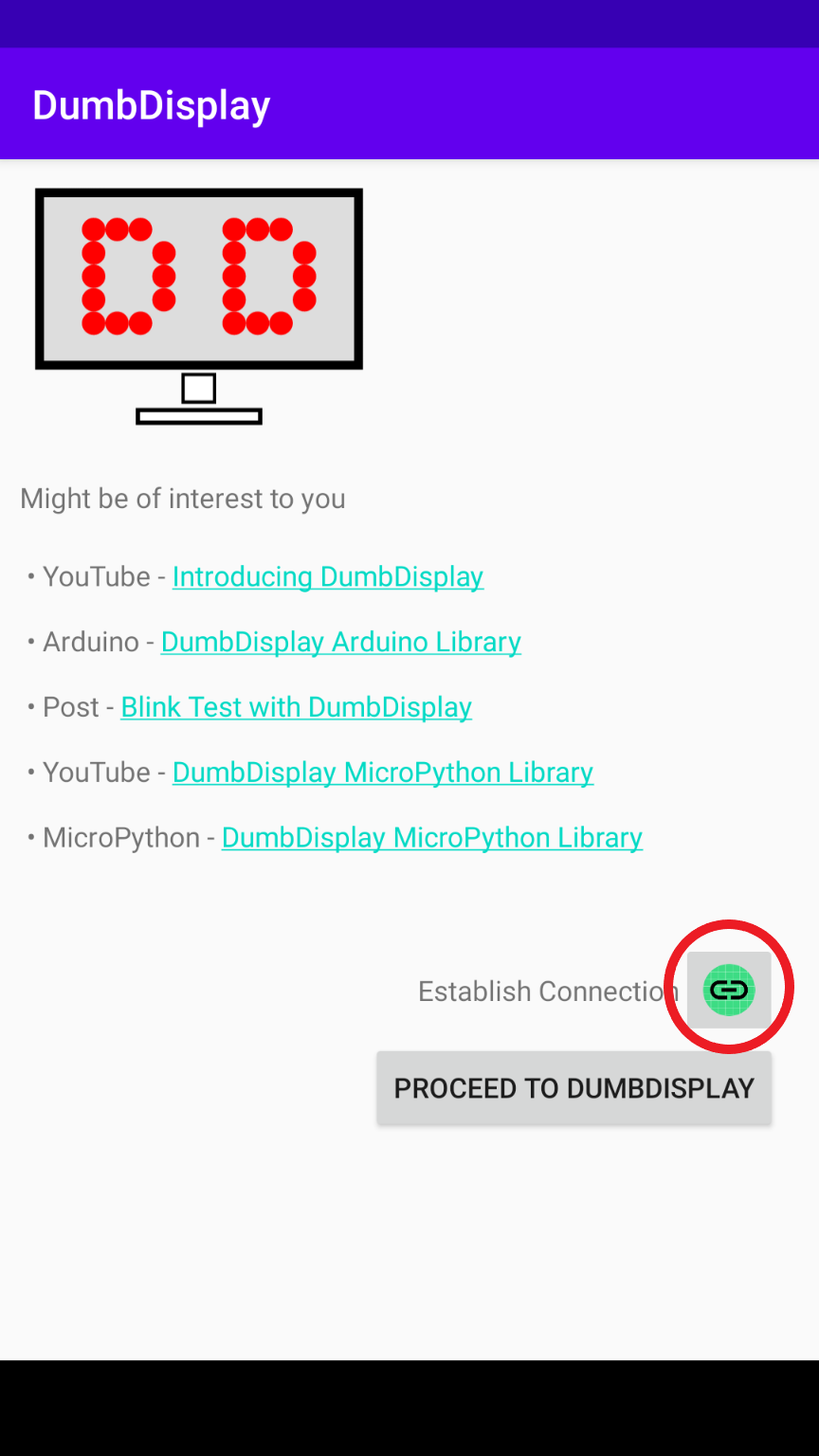

Step 7: Code to Make Use of DumbDisplay
Now, let's make use of DumbDisplay Arduino library to drive DumbDisplay Android app as UI for the said customizations.
The previous step already installed the DumbDisplay Arduino Library to the project, and you can download and install the DumbDisplay Android app from Google Play Store.

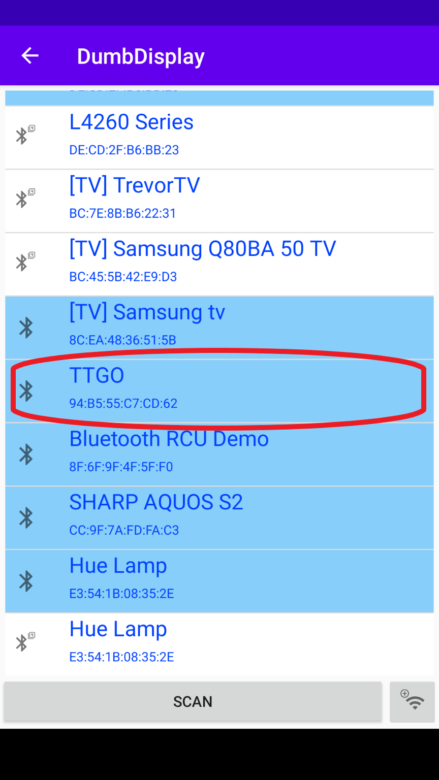

  • The code segment includes the needed DumbDisplay header file specific for using ESP Bluetooth connectivity IO object -- esp32dumbdisplay.h
  • Indeed, Bluetooth is how your TTGO T-Display will be connecting to your DumbDisplay app. Notice that the Bluetooth device name for your TTGO T-Display is set to "TTGO"
  • The code segment also declares the global variable syncButton -- a pointer to an LCD layer object, that will be created when connected to DumbDisplay app

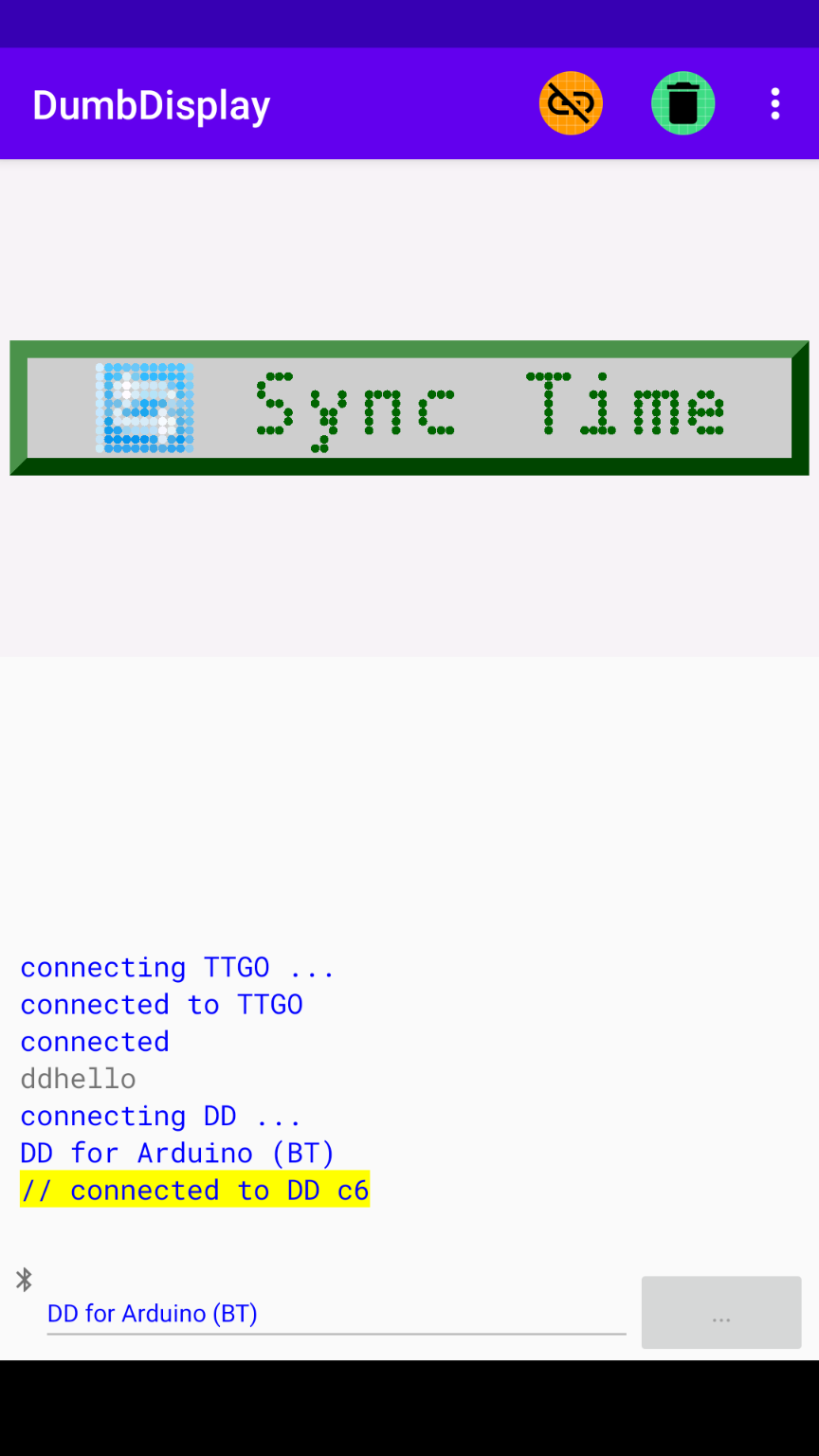

    if (syncButton == NULL) {
      syncButton = dumbdisplay.createLcdLayer(14, 1);
      syncButton->border(2, DD_COLOR_darkgreen, "raised");
      syncButton->writeLine(" 🔄  Sync Time");
      syncButton->enableFeedback("fl");
  • At the beginning of every loop, first try to make connection to DumbDisplay app non-block by calling connectPassive()
  • If connected and syncButton is not yet assigned with a created LCD layer, create one by calling createLcdLayer() and assign it to the syncButton global variable
The code modification so far only enables connection to DumbDisplay app; once connected, a "Sync Time" button is shown. Try uploading the program to your TTGO T-Display and make connection with DumbDisplay app, and see that it is working.

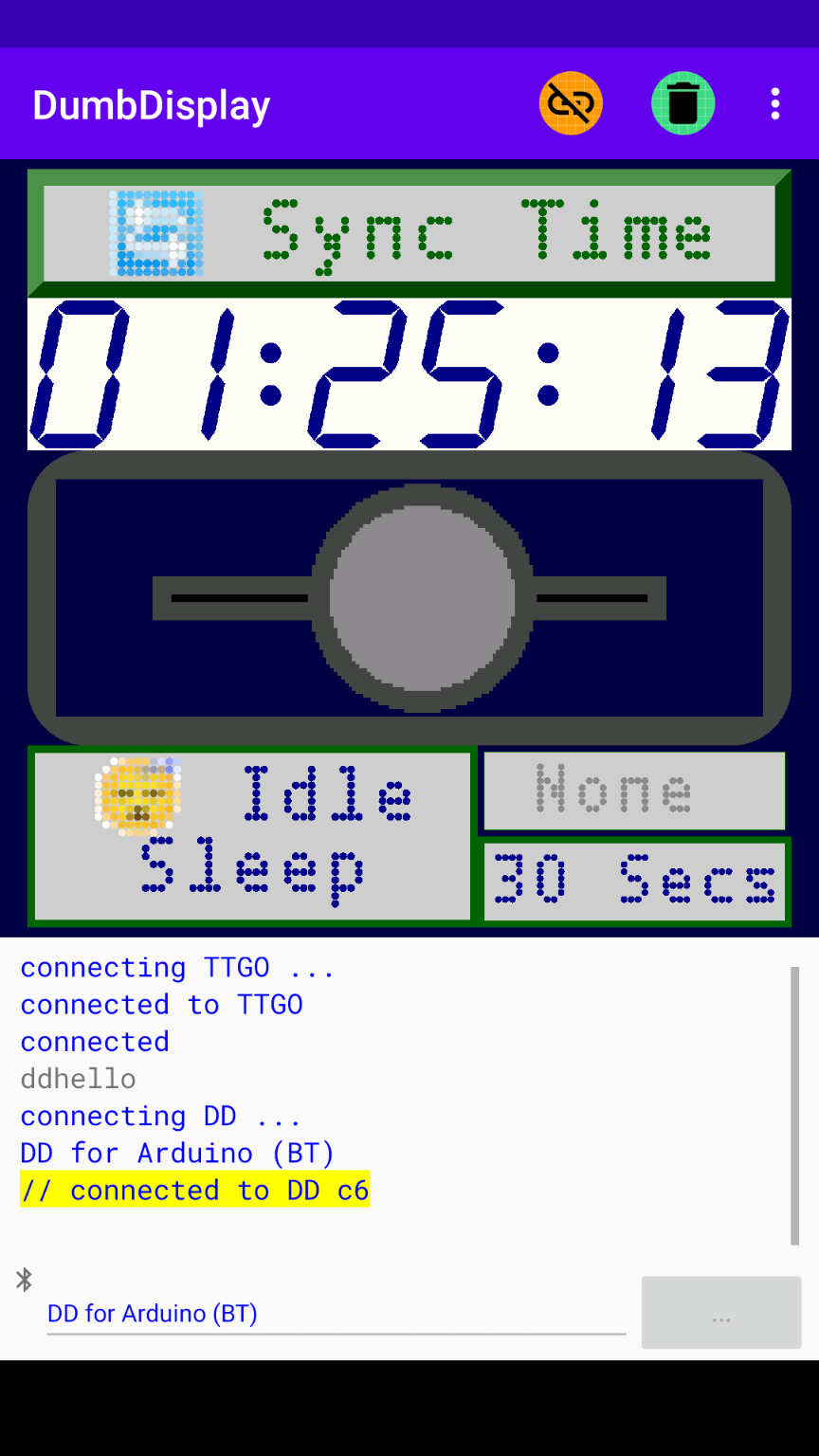

Step 10: Adding Idle Sleep
Since ESP32 supports sleep mode, why not add idle sleep to the project?
OK. For this simple project, a few things:
  1. Idle means not connected to DumbDisplay app
  2. Pressing the left button (pin 0) of TTGO T-Display wakes it from idle sleep

During sleep, you would not be able to make connection between TTGO T-Display and DumbDisplay app. However, you should be able to make connection once TTGO T-Display is awakened.
Note that when DumbDisplay app is connected and is in the foreground, your phone will not go to sleep. If DumbDisplay is put to the background, connection will still be kept.
Build it, upload it, and try it.

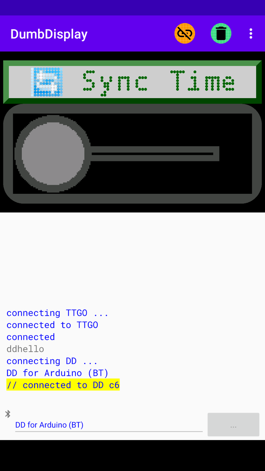

The remaining customization is to customize the clock's background color. To enable this customization
  • On TTGO T-Display coding clock face side, a few places need to be modified.
  • On the UI side, a DumbDisplay "slider" layer is used to adjust the clock's background color, ranging from 0 to 127 (i.e. color range close to the blue spectrum)
First, add the following global declarations
JoystickDDLayer* blueSlider;
RTC_DATA_ATTR uint32_t clockBackgroundColor = 0;
  • blueSlider is used to point to the "slider" layer object for adjusting the clock's background color; note that the "slider" is actually a Joystick layer
  • clockBackgrounColor is the clock's background color
The actual "slider" layer object is created and set up like
      blueSlider = dumbdisplay.createJoystickLayer(127, "hori");
      blueSlider->moveToPos(clockBackgroundColor, 0);
      blueSlider->border(5, DD_COLOR_darkgray, "round", 3);
      dumbdisplay.configAutoPin(DDAutoPinConfig('V').build());
      dumbdisplay.backgroundColor(DD_INT_COLOR(clockBackgroundColor));
  • a "slider" object is created by calling createJoystickLayer() giving it 1) maximum value (127); and 2) its orientation ("hori" in this case)
  • update the "slider" position according to colorBackgroundColor
  • Auto pin the created layers vertically by calling configAutoPin()
Handing of "feedback" due to sliding blueSlider "slider" is like
  if (connectStatus.connected) {
const DDFeedback* fb = blueSlider->getFeedback();
    if (fb != NULL) {
      // got "feedback" from the "slider" => use it's x value as color background color
      clockBackgroundColor = fb->x;
      initial = 1;
 } else {
  • When the blueSlider "slider" is dragged, check for "feedback" by calling getFeedback()
  • If "feedback" got (DDFeedback object), check the "feedback" x value (from 0 to 127)
  • Set colorBackgroundColor to the x value of the "feedback"
  • Also set the "slider" background color accordingly as well
  • Set initial to 1 to force redraw of the clock face

  • the clock's time is also shown in the UI
  • can use the UI to disable idle sleep
You can simply copy the complete code to the project's src/main.cpp. Build it, upload it, and try it.
