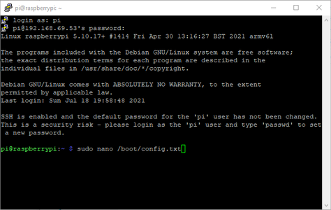

Step 1: Open Config.txt
First we have to open the config.txt file. Depending on your Debian version your file is located in a different Folder.
For newer versions after Bookworm it is this command:
sudo nano /boot/firmware/config.txt
For older versions before bookworm the command looks like this:
sudo nano /boot/config.txt

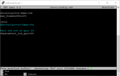

Step 2: Change Config.txt
Choose a GPIO you want to use I'll be using GPIO 25. Now add the following lines to your /boot/config.txt :
#act led now on gpio 25
dtparam=act_led_gpio=25
Note that the first line isn't necessary but it might be helpful to remember what you have changed.
Step 3: Save and Close /boot/config.txt
Press ctrl and X . Then after it asks you to save the modified buffer press Y to save and close.

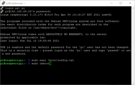

Step 4: Reboot
Type
sudo reboot
to reboot. Now you have done the software part.

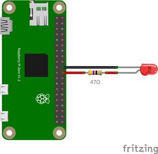

Step 5: Building the Circuit
Connect the cathode of the LED to GND (Ground). Connect the anode of the LED in series with a 47 Ω resistor to the GPIO you have chosen before.
