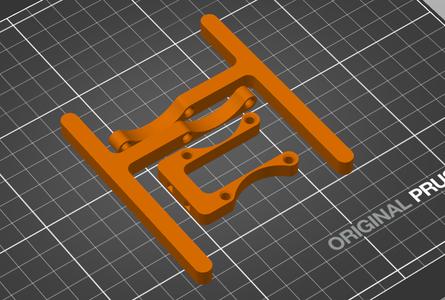

Step 2: 3D Printing Some Parts
Time for some 3D printing! I've designed two variations for the fan center spacer, one which connects between the two fans (recommended) and one that doesn't. The connected version of the center spacer also has slots cut in it for a zip tie to secure all the wires. If it is so desired to print the separated fan spacers, print two of them.
