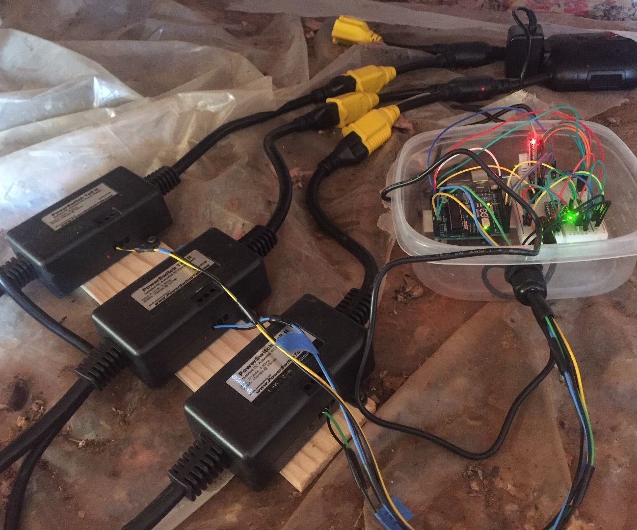

I must be extra talented (feel the sarcasm, please!!) because I regularly get random hangs in my projects that defy the built-in watchdog and simply stay hung. Given that winter is here, I need my crawl space monitor (more on that later, maybe) to work to keep my pipes from freezing. I work over 40 miles from home and the family has been out of town extensively lately. I had to come up with a solution for the working prototype while I continued to work on "v 0.2" trying to add a bit more stability to the project...
My solution was to add Adafruit's $6.95 Trinket (ATtiny85 on-board, 8K of flash, 512 byte of SRAM, 512 bytes of EEPROM) to the project. I use it to monitor a "heartbeat" signal from the "real" controller for the project (a Metro Mini in this case). The Trinket LED flashes according to the heartbeat signal, so I have a visual on both controllers at once. When the heartbeat times out, the Trinket brings the Reset pin of the host controller to ground and then brings it back high.
I have yet to cobble together enough of a monstrosity that this has failed on me!

Step 1: Coding the Heartbeat (host Controller)
On the host, pick a pin and cycle it between high and low. Here is the code I use to cycle pin 4 every 3 seconds (mostly):

Periodically my app branches into a subroutine that takes about 15 seconds to run -- this has to be taken into consideration when I set the values in the Trinket's code.

Step 2: Coding the Watchdog
Here is the Trinket code, complete. timer.h is identical to the previous step.
Note that I set a 30 second heartbeat timeout -- this gives my main sketch plenty of time
to run its 15+ second subroutine and toggle the heartbeat state without timing out.
(The LED not cycling during that time is inconsequential, as there is other, visible activity
taking place.)

Step 3: Wiring It Up
The Trinket and the host controller should be powered by the same source, allowing them a common ground.
Connect the host's hbPin (4 in my example) to the Trinket's hbPin (3 as shown here). Connect the host's Reset pin to the Trinket's resetPin (4 here).
Step 4: Test It
Apply power to both devices. Once your host controller gets to loop(), you should see the Trinket LED start pulsing in time with the heartbeat value you have set. After resetTime, disconnect the connection between the hbPins of the two devices. At hbTime, the host controller should reset just like if you had pushed the reset button.
Step 5: Deploy It!
This is a cheap, rock solid solution that I am already using several places. Anything I am deploying remote or "mission critical" will certainly have it onboard!
