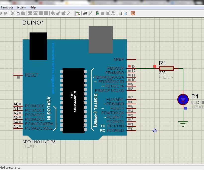

Step 3: Writing a External Interrupt Code (step-1)
Aim to do: We will initialized our aruino to sense the external interrupt in digital pin 2.Through this external interrupt we want to complete a task.The task is, toggle LED on pin 13.That is if the led in the 13 pin is on,then after getting the external interrupt 13 pin is off.

Step 7: Writing a External Interrupt Code( Final Code) (step-5)
void setup()
pinMode(13, OUTPUT);
attachInterrupt(0, blink, FALLING);
void loop()
//Add your task
void blink()
digitalWrite(13, !digitalRead(13)); // Toggle LED on pin 13
