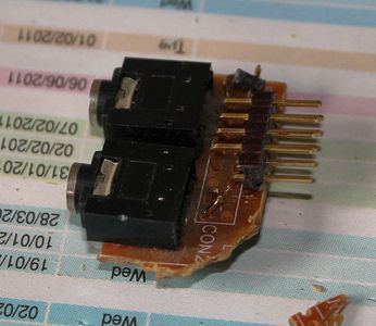

I'm quoting this because I want to save you some hassle. I borrowed an expansion card, shown below, from one of my older computers. It had fried a long time ago and was useless otherwise so I thought I might as well borrow the header off it. Bad idea! The thing was glued and soldered, so was only coming off in pieces.
I would advise you to buy some headers, as they come in handy for a lot of projects, and if not you should look for the second type below. I recovered it from another case, and it was broken so fair game. It was a lot easier to work with and didn't fall apart. You can solder the USB wires directly to the internal card reader or what ever else you are working with, but using a header is less destructive.

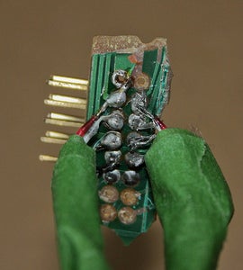

Step 2: Harvest Your Header (if Needed)
I took the broken front panel connector from an old case and cut off the non-required parts, everything except the header. The header was larger than required, so I cut it down to the usual 9 pin arrangement (4 pins and a missing pin one side, and five pins the other).
I left it on the PCB this time for some support after the last one fell apart :/

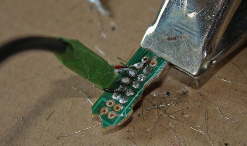

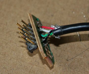

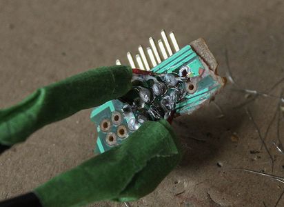

The two USB cables should be identical, and both sides of the header are the same, aside from an extra pin on one side, though it isn't important for us. Follow the pin guide below, and from top to bottom the order is: red, white, green and black.
When both sides are soldered they should look essentially like a mirror image, and you are pretty much done. Make sure the wires are not shorting out as this would cause problems. If you have electrical tape you can insulate the wires where they have been stripped, or better yet, heat shrink tubing would work nicely.
Mine is still rough and ready, but the important part is that it works well.

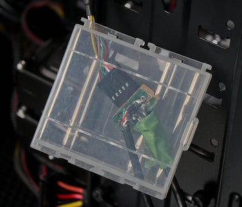

My finished cable was very basic, and not particularly strong so I used a battery case to house it. It needed a few cuts to allow the wires to pass through, but it protects the assembly well. It is now screwed in behind the hdd cage and well hidden.

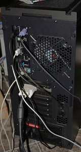

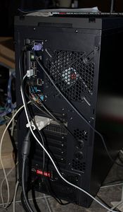

Of course, you still need to plug it in! I was fortunate because my case came with watercooling grommets, so I passed the USB cables through them and into the rear ports. The interface requires two USB ports to work as each header supports two ports. (In the case of the internal card reader - one for the usb port, and one for the card reader itself)
