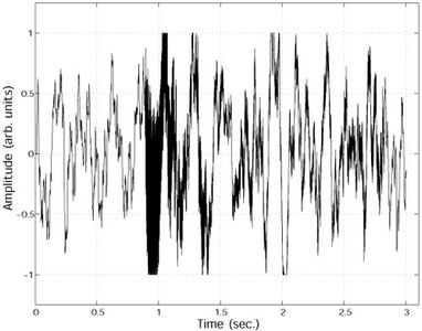

I added two sound files, the recording and the song. You need to open them both in audacity invert one of them, and play them together perfectly in sync.
I have cut them both to the same size, synced to make this easier.
In an real situation, you could have more background noise and more dificulty adding the two sounds up, but this is just the principle.
Sound is a sequence of waves of pressure that propagates through compressible media, so if you add a inverted equivalent the waves cancel out.This effect is also used in noise canceling headphones and some cars to bring the noise down as much as possible.The problem in actual space is that the waves go trough and bounce of things, slightly changing as they do , so while the noise canceling headphones can work perfectly, the canceling in a car or space around us is not perfect. Another point worth mentioning is that if you slightly miss the timing the sound you intended to cancel will be amplified.
