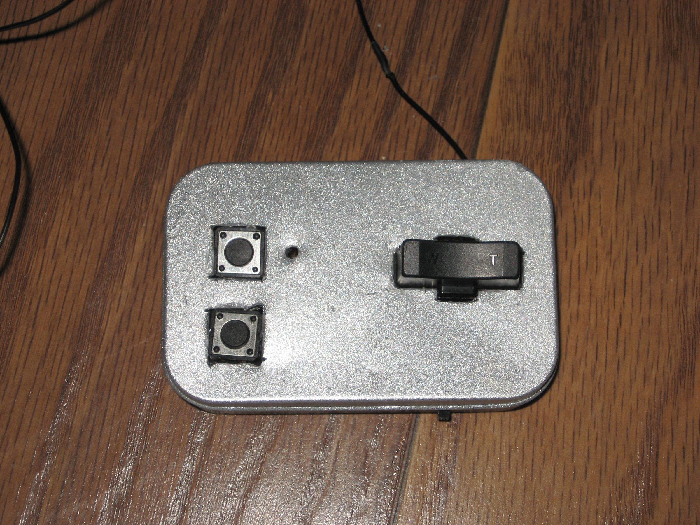

More improvements in the coding and functions. Designed and etched a custom board for the lights and stuffed it all into a radio shack box. There are provisions for two buttons in the code but I have yet to implement functions for the second button. I also took out the PIR functions but the custom board has a place for a PIR sensor and it wasn't too hard to add that functionality. BRD and SCH files to come soon.

I had some time over summer so I went ahead and made a board for my circuit and made it a little nicer than the jumble of wires on top of the protoshield. I added the 4066 chip in the schematic so that I could interface with a cheap push button iPod controller but I never got around to actually implementing that part. My eagle design skills at the point that I made this board were somewhat lacking but the circuit does work, just make sure to use a steady 5v power supply with the controller. All of the connectors are headers in the schematic as I was mounting it in a box and wasn't sure where I was going to put things so I just soldered wires to the audio jack and buttons and such and then hot glued it all into the case. Its not pretty but as I said before it does work. There is some code for the board below. If you have any questions about this version, feel free to ask.
