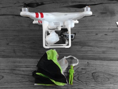

I have a DJI Phantom 2 Vision with a built-in camera and First Person View (FPV) through an iPhone or iPad app. The on-board camera on the quad has a tilt adjustment that can be controlled remotely, so I was working at designing a simple mechanism to release the toy parachute using part of the existing tilt mechanism; I could add a remote servo but I wanted to avoid the additional electronics. I also wanted to be able to film the release of the toy parachute, so I needed to attach my GoPro to the quad, as the built-in camera wouldn't shot footage straight down. I put a post on the Instructable forum asking for some ideas, and thanks to all those users that provided me with some great ideas.

I actually came across the release method purely by accident. I thought I'd start by fitting the GoPro mount to the quad to see if it would fly with the additional weight, and by chance when I alined the GoPro mount right at the back of the in-built camera, I could see the built-in camera plug made contact with the GoPro mount, I used this to form the 'closed position'. If I was to tilt the built-in camera in flight, this would break the contact between the GoPro mount and inbuilt camera, creating a space and what I could use for an 'open/release position'. See images above. So all I needed to do was add a small keyring to the top fabric of the parachute, to tidy up the release of the parachute and it was good to go.
