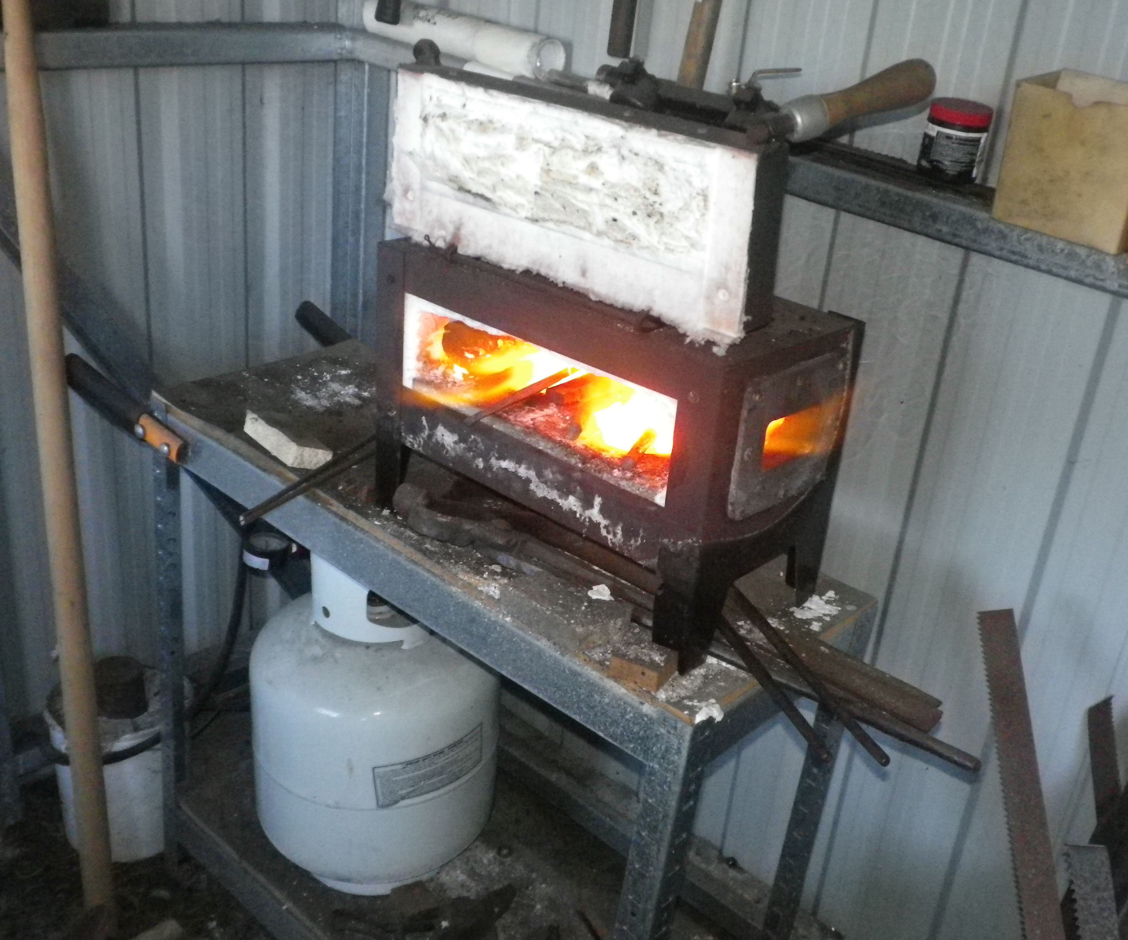

Heat up all the spring steel washers in the forge, and straighten them.
You will also need to clean the washers to remove the fire scale.

Forge weld the stack, fold as many times as you like, these materials forge weld easily.
Amalgamate into a single billet.
Heat and twist the billet.
As there is not much material you need to slightly flatten the spirals, and then grind until flat.

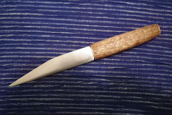

Take the reserve washer, the welded billet, bind and forge weld.
Step 5:
Forge the the billet into a rough blade.
Grind the knife into the desired shape.
Sand and polish the blade.
Heat treat, then sand and polish again.

After acid etching you get this.
There's not that much to write, it's a very easy project.
