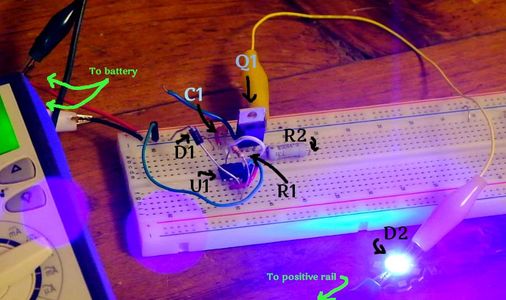

For this circuit, you will need an op-amp of a suitable supply voltage tolerance for your power source, as well as a MOSFET with a Vth small enough to be fully turned on by a high signal from the op-amp. In this case, I would expect to get an ON voltage of at least 2 V from op-amp, so I chose a MOSFET with Vth = 1 V to give it a good margin of error. Generally, MOSFETs don't perform well if operated too close to Vth. D1 sets the reference voltage, to which the voltage across R2 is compared. This is not the most stable voltage reference, and that is one disadvantage to this design, but it has the advantage that the sense resistor voltage can be minute, making the design vastly more efficient and capable of operating at low voltage than any common linear regulator IC. The smaller R2 is, the higher the current limit. C1 is important to prevent oscillation, and for it, I would recommend a ceramic capacitor. The exact value of C1 is not important. D2 just happens to be what I was powering with it - it could be any load component. Please note that if you use the same op-amp as I did, I would recommend operating it in low-bias mode (connect pin 8 to the positive lead of your power source. On a somewhat tangential note, one common source of rechargeable Li-Ion batteries is from disposable vape pens, which can often be seen littering the ground in any location where people go to smoke. I recommend wearing gloves if you open one, as the smell of the vape juice is most vile, in my humble opinion, and it lingers on anything it spills on.

Step 2: Assemble Your Prototype
Some notes on construction:
  • C1 should go directly from the gate of the MOSFET to ground in as short of a path as possible.
  • If your set current is close to the maximum current of your load device, use a slightly higher-value R2 to start out with to make sure it doesn't go up in smoke (the previously mentioned current calculation does not account for variation in components). You can always swap for a smaller resistor later.
  • An optional slow-turn-on feature can be added by placing a 10 kOhm or lower resistor between the op-amp output and C1, adding a 1-2 MOhm bleeder resistor in parallel with C1, and increasing or decreasing C1 for the desired time delay. This will slow the regulation, so only use this if powering it with a battery or other very low-transient source.
  • Touch something metal to ground yourself before handling the MOSFET.
  • If using the TLV2341, don't forget to set it to low-bias mode by connecting pin 8 to the positive voltage rail.
  • High power LEDs need to be heatsinked if driving them at high current
  • If you expect the MOSFET to dissipate more than 1 W at at the maximum input voltage, it needs a heatsink too
  • It's fine to test the circuit without any heatsinks, just don't leave it on for too long
