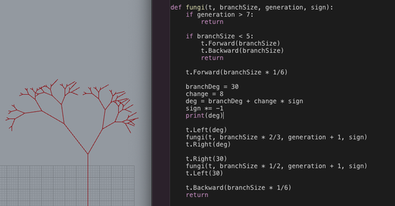

I wrote a recursive function to draw the branching.
The Logo Interpreter has a sample tree function that draws similar branching.
Sketches like this fungi simluation & this fractal simulation in p5 were also inspirations.
I wanted to add some randomness to the branches, so they look a bit more "organic". Initially, I added random degrees between -15 and 15, to the branching angle. However, I didn't consider that since we need multiple layers to trace the design, the design needs to be a bit more deterministic. Generate different branching angle each function call in each layer resulted in pic#2 above. So I fixed the change to the branching angle, flipping its sign before each recursion call.
