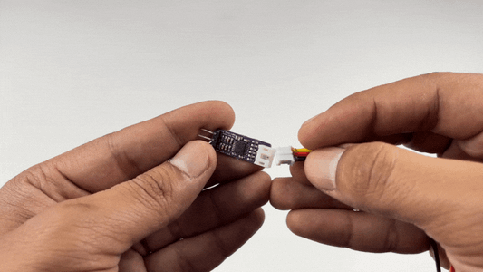

Step 3: Connecting Electrode Cable
Connect the BioAmp Cable to BioAmp EXG Pill as shown in the connection diagram. We have different variants of the BioAmp Cable so don't go with the color coding and focus on the REF, IN+ and IN- written on the BioAmp EXG Pill.

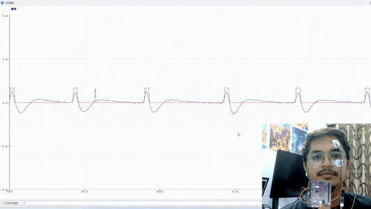

After flashing the code, open the serial plotter to visualize the EOG signals and detect the eye blinks.
Step 8: Blink Your Eyes
Blink your eyes and detect the eye blinks on the serial plotter of Arduino IDE, LED of Maker Uno and the buzzer as shown in the video above.
Now you are all set to explore on your own and make amazing HCI projects at the comfort zone of your home.
