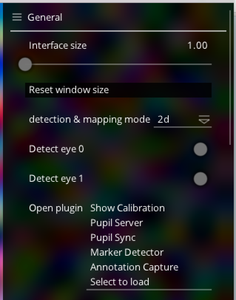

This will install the library dependencies for eyerobot. Finally, download and install the Pupil app from here.
Now that you have Pupil installed, launch it and enable the Pupil Server plugin. This will allow it to communicate with the eyerobot program. Also, enable the Marker Detector plugin, so it can detect your gaze on your computer screen.

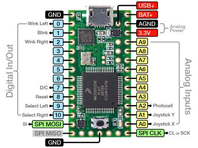

The switch uses a Teensy microcontroller configured to act as a USB keyboard in combination with a capacitive sensor (the kind in smartphone touch screens) to become a makeshift touch switch.
First, solder the wire and resistor onto the hole of the dogtag.
Then, slot the Teensy into the breadboard.
Connect the dog tag assembly to the breadboard so that the wire goes to pin 4 and the resistor goes to pin 7. You can refer to the above diagram for a reminder of which pin is which.

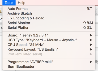

Next step is to program the Teensy. First, install the Arduino software version 1.6.7. As of this writing, that is the latest version of the software that works with the Teensy 3.2. Run the Arduino software once and then close it. Now, install the Teensyduino addons for the Arduino software. You will need this to program the Teensy from Arduino.
Plug the Teensy into your computer via the USB port. Ensure you have the correct options selected for your Teensy under the Tools menu (refer to the image for more details). Type the code from this Github gist into the Arduino IDE. Finally, click "Verify" (the checkmark button) and then "Upload" (the arrow button). Press the black reset button on the Teensy when it prompts you to do so.

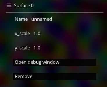

The last step is to calibrate Pupil. Place the Pupil headset on your head and open the Pupil capture app. Two windows should open, one for the world camera and one for the eye camera. Make sure the eye camera has a good view of your eye; you can check by going to the eye camera window and making sure there is an outline around your pupil with a red dot in the center. If there are eyelashes blocking the camera, you might need to turn off the "coarse detection" in the Pupil window.
Next, you will need to add the computer screen as a surface to Pupil. This will allow Pupil to report the position of your eye gaze on the screen. To do this, open eyerobot and make it full-screen so that the four QR-code-like markers on the corner of the screen are visible in the world camera. Then, in pupil, press the "A" (Add Surface) button to add it as a tracked surface. Finally, rename the surface to whatever you chose in the eyerobot configuration.
The last step is to calibrate the eye tracker. This lets the program know which eye gaze position corresponds to which real-world location. Calibration is really simple. Just press the "C" (Calibration) button in the same column you clicked the Add Surface button, and look at the targets as they come up! There are a total of 9 targets.
