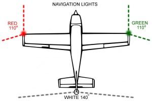

Step 3: Tape Lights on the Wing
Slightly bend the LED leads so it's flush against wing tip, secure with masking tape. Remember to match FAA guidance :D
