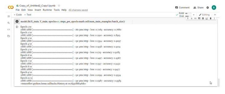

The EMNIST dataset is used in the project for extraction of numbers and letters from the license plate. The X input is normalized and Y labels are to be resized in the format of one hot representation 36 classes – 10 digits and 26 alphabets.
Create a CNN model with depth as per the need. Pooling layers can be avoided due to the small size of the input. Add sufficient dense layers to accentuate the classification. With the depth of 4 CNN layers, 3 dense layers and a mini-batch gradient descent, an accuracy of 96% in the training and 89% in the test set was obtained. Adam optimization is used. You are free to try out various other optimization techniques.
