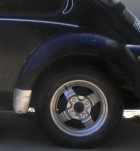

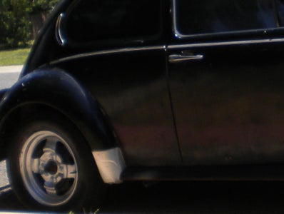

Step 4: "STREET APPEAL"
Finally, the wheels were torqued on with zinc-plated lug bolts, and we were ready for prime-time.
I am satisfied with how these fake mags look, out on the road or in traffic.
I don't think there's any reason to use locking lugs.
After its first full-service car wash in 21 years, it's portrait time. SMILE !!
(The car wash cost more than creating these "Faux Mag Wheels").
