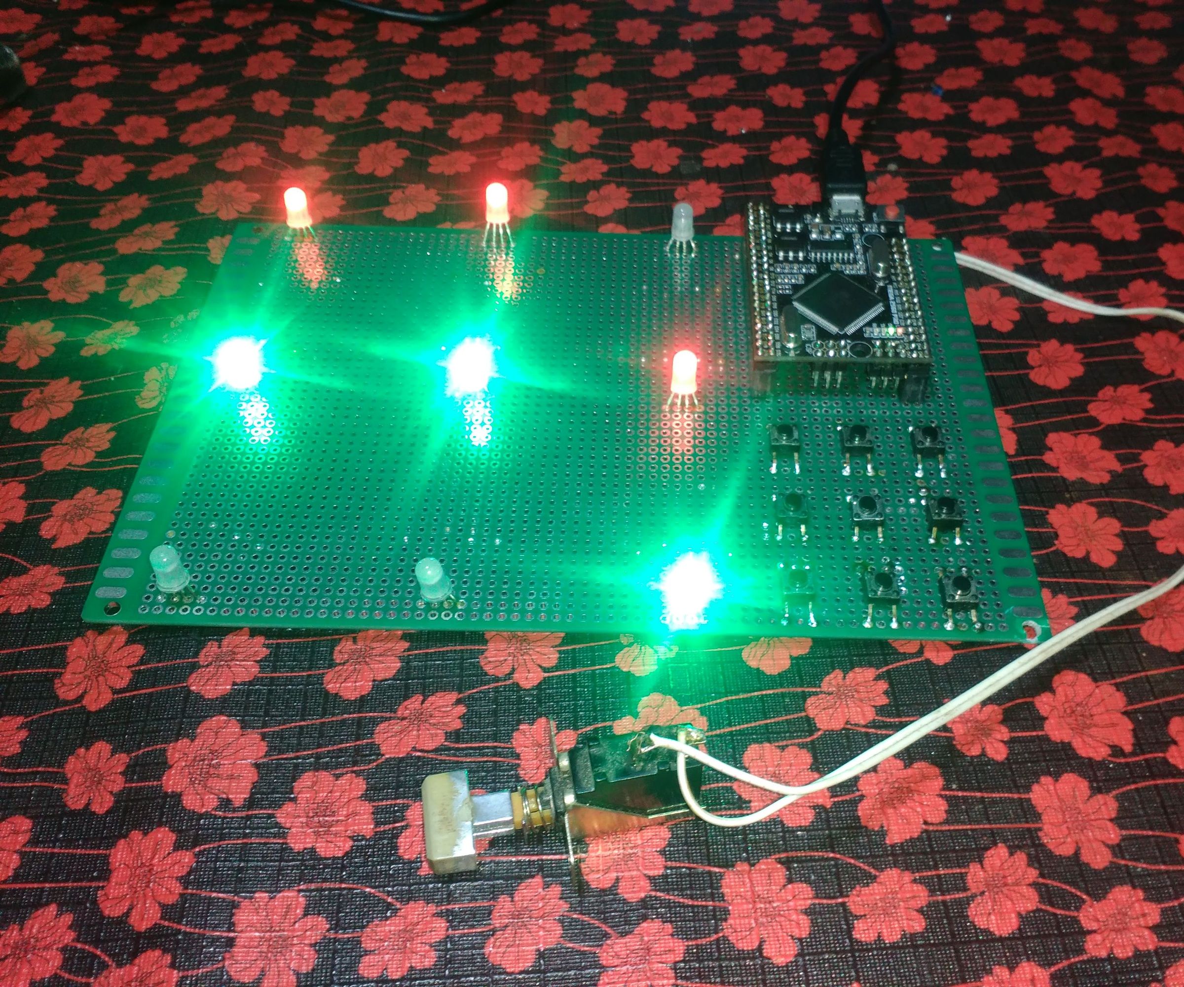

Step 3: Power Distribution and Motor Driver Board
In this project we are going to coordinate more than 10 sensors and modules together. Each of them needs different voltage ranges.The sensors and modules added in this design (FEDORA 1.0) needs only 5V supply and the micro pump and exhaust cooler fan needs 12V supply. To provide power supply to each and every components , we need a power distribution board which can provide both 5V and 12V. So we fabricated a circuit as shown in the figure above for this application.In addition to that we attached two L293D ICs in this circuit for drive the Stepper motor,cooler fan and micro pump.
For make this power distribution and motor driver circuit, we want
- 7805 Regulator IC
- 2x L293D Motor Driver IC
- Header pins (Black for GND ,Yellow for 5V, Blue for stepper motor input,White for Arduino input)
- 1x 10uf/63V Capacitor
- 1x 1uf/63V capacitor
- 1x 1k resistor
- 2x 2 channel screw terminals (For cooler and pump)
- Barrel jack / Socket matching for your AC-DC adaptor
- A zero PCB
- And a piece of heat sink for 7805
(Solder two header pins instead of LED , we can add this LED to our pot later )
Note:
Don't forget to add 'heat sink paste' before fixing 7805 IC on the heat sink piece.
Choose a right socket which can match with the output pin of your AC-DC 12V/2A adapter
If you want to add any modules (like audio amplifier) , which are working at 12v , you just needs to add some header pins (I added some red header pins for this in my circuit , but not used in this project)
