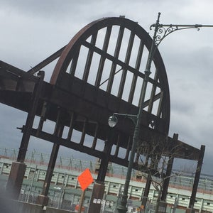

This should be obvious, but all artists have something that turns their engine over. Me personally, I like Greek Antiquity, Modern architecture, urban infrastructure, industrial history, mining and the romance of magma. But you do you.

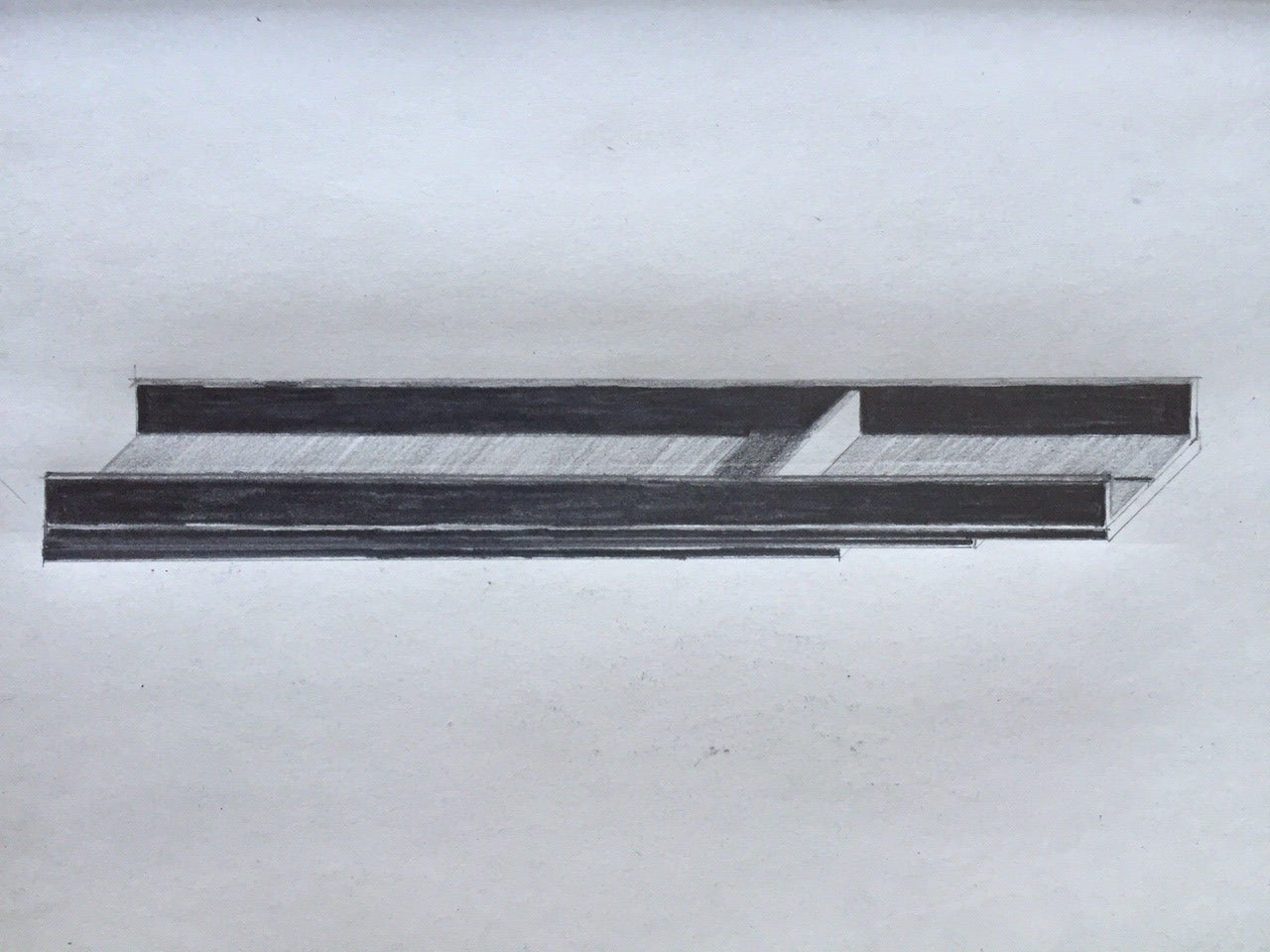

I walk around New York City and take photos and then I write about my feelings and draw.

The way this works is, you make some drawings and cut lists to determine what sections of material you need and how much. These types of decisions seem boring compared to the act of sculpting, but actually choosing the right scale and ratios of dimensions is the most important element of sculpture. So plan wisely, and always account for error by ordering a little extra.
