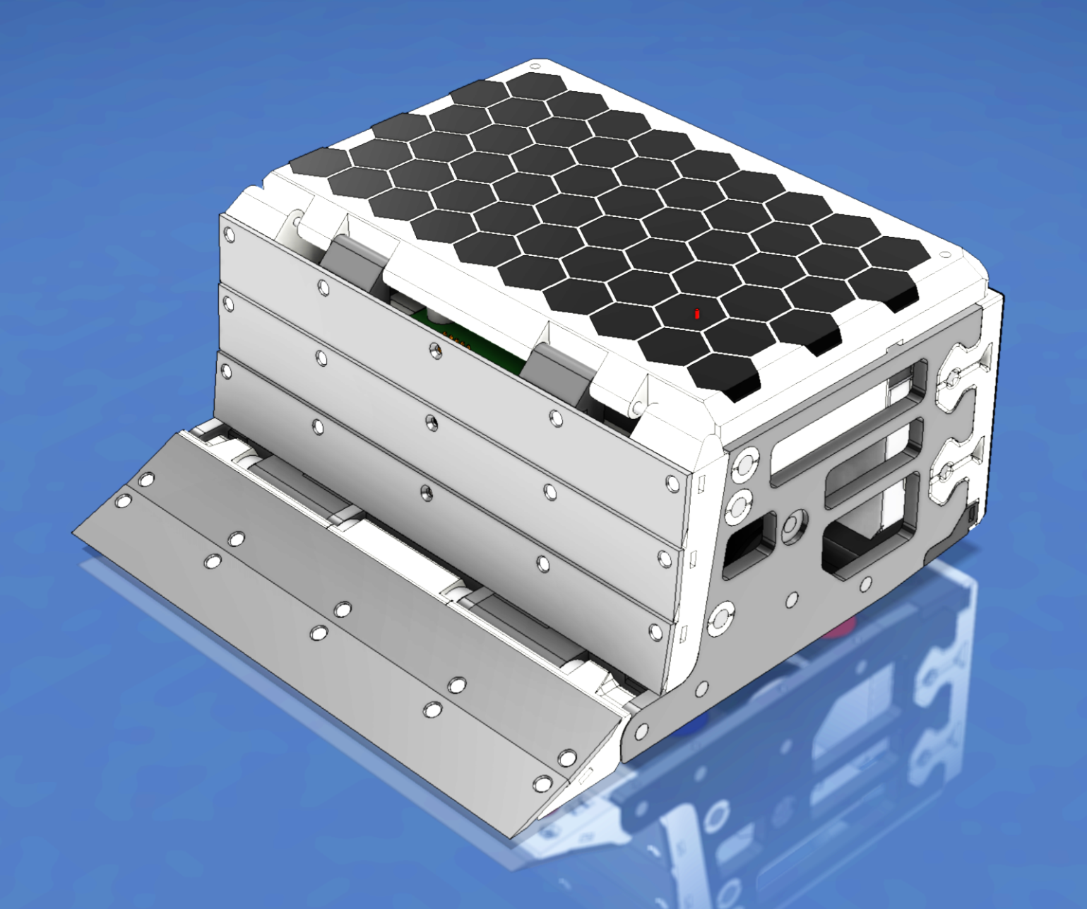

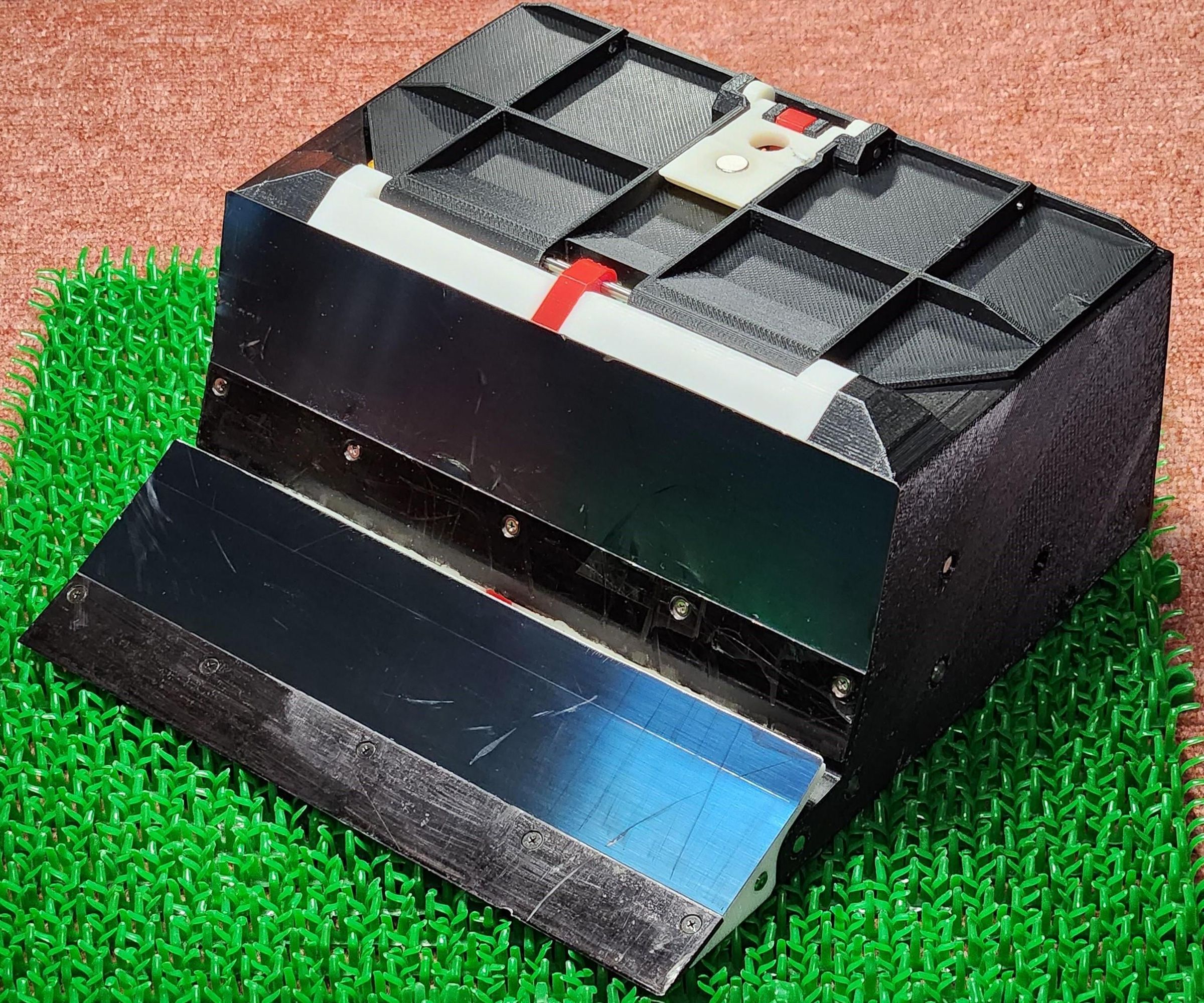

Step 1: My Robot Problem Part 1
Due to the interference between the sensors of the enemy robot and my robot, my robot will meander when approaching the enemy robot.
It seems that my robot needs to change the placement or type of sensor on the front.
Step 2: My Robot Problem Part 2
When my robot pushes the enemy robot, the enemy robot passes over my robot.
It seems that my robot needs improvement in its front shape.

Step 9: Assemble the Main Body.
Assemble the main body using the 3D data as a reference.
Step 10: Front Armor Installation
Using a cutting wheel, make a notch in the number 5 blade. Please refer to the 3D data for cut dimensions.
Use double-sided tape to combine the blade with the notch and the blade screwed onto the main body.
