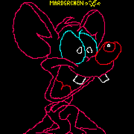

Some pictures.. think this explane better some settings than text does.. (the colors still moving, but you can see this on pictures..)
