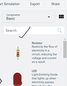

In the TINKERCAD software you may simulate any circuit of your own.
For setting up the circuit choose the components needed from the search box.
After choosing and placing the components on the working space, then set the value of the resistor accordingly.
For making the circuit clear and precise we could annotate them by naming each components.
