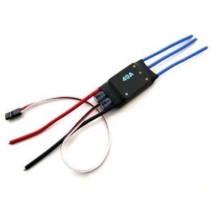

Input supply wire of ESC is connected to 11.1V battery. Three output wires of ESC are connected to three-phase inputs of BLDC motor (M4).

We used Red Brick ESC module. If you use any other ESC module, you may have to modify delays in the code accordingly.
