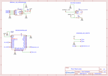

Step 1: The Circuit
The circuit includes four main components:-
  1. ESP32S Microcontroller
  2. WS2818B LED Strip
  3. INMP441 I2S Microphone
  4. Power Supply
The ESP32 is connected to the laptop via USB cable.

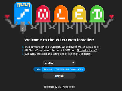

Search the WLED install webpage.
Drop down the version tab, select v 0.13.4 and flash .
Connected the circuit as shown. Turn it on. An access point (WLED) can be seen on available WIFI connections.
Connect to it, enter the WIFI credentials and set up the pinouts on the WLED webpage.
Once done, restart WLED. On your phone app, the WLED access point(s) should be visible on the phone app as 'WLED'.
That's it! Easy, right?
Important points to note
  1. ESP8266 & ESP32 C3 Mini are not compatible with the sound reactive version. They do not have the compute power to perform FFT in real time
  2. Analog microphone do work, but are susceptible to electrical noise, have low SNR and do not perform as well as digital microphones
  3. Power supply rating depends on the level of brightness and number of LEDs you plan to use. 15 watts for 90 LEDs at half brightness works well for me.
  4. ESP32 does not have dedicated I2S pins. It needs to be configured to specific GPIOs

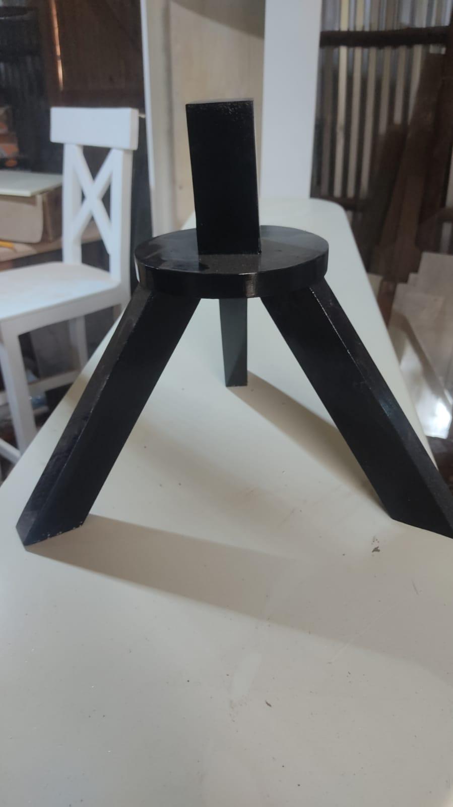

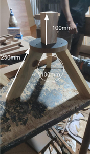

For a stable lamp, the design includes three legs spread out at a 45 degree angle.
Wood primer is used for a smooth and even pre spray paint finish.
Finally spray paint for the desired finish.

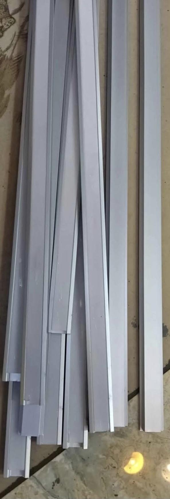

The aluminum profile is attached on the stand using screws. The LED strip comes with an adhesive which can be exposed once the top layer is peeled off.
Stick the LED strip carefully on the aluminum profile and insert the diffuser and you are done!

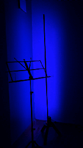

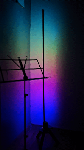

Step 3: Demo
Once the build is done power it up! Select you favourite mode.
Here are some pictures and videos
