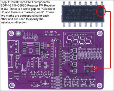

Step 1: Install 1pcs SMD Components SOP-16 74HC595D Register FM Receiver at U3
There is a white gap on PCB silk screen at U3 and there is a mark(dot)
on IC. These two marks are corresponding to each other and are used to specify the
installation direction.
