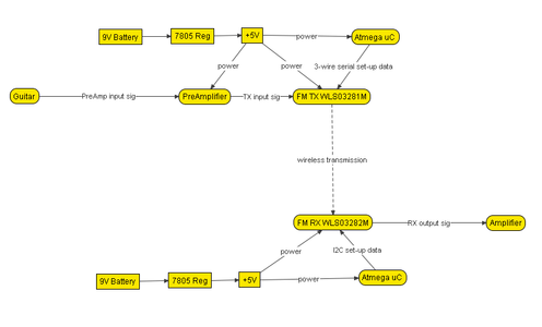

Attached is an over-arching workflow of this little project. We use a regulated 5V supplies, from 9V batteries, to power our microcontrollers, preamp and transmitter/receiver. The microcontrollers send an initial stream of data to configure the transmitter/receiver for their individual roles. We'll be using the 104.5Mhz frequency, though you can easily adjust this in the code given.

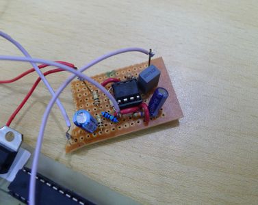

The Preamplifier will be constructed using a TL071 opamp. We'll bias it at 2.5V from the 5V supply, and set a gain of around 5 – this is enough to increase the guitar volume enough to improve SNR in the transmission, yet small enough to not to cause the audio input at the transmitter to clip. You can try to omit the preamplifier but you'll have significantly more noise in your received signal.
Also, if you haven't figured out already, we'll be using capacitive coupling to link together all the audio in/out signals – The Preamplifier has a DC output voltage of 2.5V which we can't afford to feed into the FM transmitter. On the FM transmitter/receiver ends, their audio input/outputs also have a DC bias so we're forced to use capacitive coupling there too.

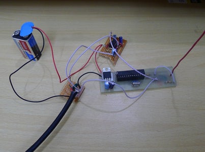

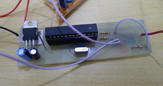

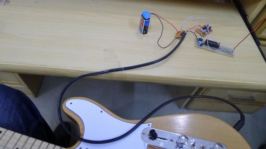

Download our Eagle schematic/layouts first. We made a bit of a mistake and ended up with 3 boards on the transmission side – 1 single-side home-made PCB, and 2 tiny perfboards. They are guitar.sch, preamp.sch, and txboard.sch/brd. Guitar.sch is the perfboard schematic we use to couple the guitar signal into the preamplifier. Preamp.sch is the perfboard schematic for the TL071 Preamp circuit. Txboard.sch/brd is the transmitter PCB board. Have a looksee at the the transmission-side setup in the attached pictures.

Some points of note:

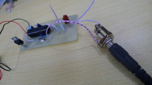

. You need to connect a piece of jumper wire, vertically, on the antenna pin on the PCB.
. Since the guitar is a monaural instrument, only 1 of the two transmission channels is needed. So connect the Left channel Input of the transmitter to ground, otherwise you'll have more noise in your final signal (The transmitter sums both channels when working in mono mode)
. Yes, the R/C values aren't godsend. : ) You can change them around if you need/have to, as long as you don't waver too drastically. As I said this isn't an audiophile-level project so incremental improvements (or degradation) in noise won't really be very noticeable in the end.
. As for the medium-sized red 'dot' in the Eagle schematics, thats just a part I myself made up to improve the board layout process. Don't mind it. : ) In fact, I suggest you make on yourself for use in your projects! Its very handy for home-made single-side boards where you have to cross some jumpers yourselves. Sparkfun has a set of very handy tutorials on Eagle in their “Beginning Embedded Electronics” tutorial category.

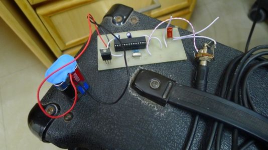

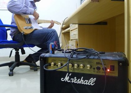

RX-board.sch/brd is the receiver-side PCB board. We soldered the TRS plug to the FM receiver output for easy connection to the guitar amplifier. Connect a 9V battery, and its ready - see the attached pictures.
