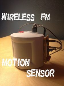

The schematic shown above shows where to solder the components. I built the whole thing on some pref board. Usually building a transmitter with wires or jumper cables flying around the board would be a big "no no" for RF circuits but thankfully with most FM bugs it doesn't really matter. If you'r a top-knotch solderer you could probably bring this down to the size of a thumb nail by using super small surface mount component. I will show how to do this in another instructable. Also make sure you solder the transistor in right because I soldered it backwards and it just won't work that way.
Step 3: Put It All Together
Once you have built the transmitter we can get on to putting it all together. I hot glued it right on to the side of the motion sensor. FYI the motion sensor only draws 20 miliamps which means low power consumption!
First take the power wires for the transmitter and put the positive in NC and the negative in C ports. They are shown in the pics above. If you're motion sensor is not labeled or is different it is very easy to find out which ports are which.
How I figured out which was power is very easy. It should be labeled + or - and to find out which is output "for the transmitter in this case" was also easy. I put my volt-meter into to ports that were right next to each other and turned the power on to the motion sensor. If you wave you're hand or move it around and you get output on the ports that means you will use these ports for power on the transmitter. If not then keep trying other ports.
