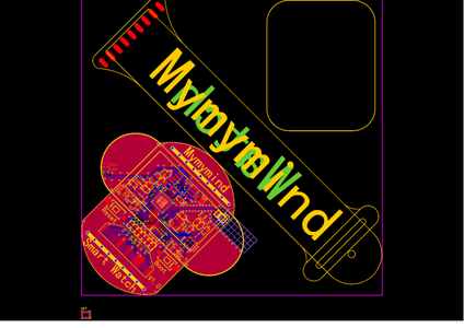

This project will develop an OLED smartwatch based on the CH583M microcontroller, featuring multiple practical functions, including activity tracking, temperature measurement, and Bluetooth communication. Utilizing FPC (Flexible Printed Circuit) materials, this watch not only meets complex design requirements but also maintains a slim and lightweight profile, seamlessly integrating into daily wear scenarios.

  1. FPC (Flexible Printed Circuit) Material
  2. The use of FPC makes the watch thinner, more flexible, and foldable, ensuring comfortable wear on the wrist.
  3. FPC enables a compact internal layout, minimizing space usage.
