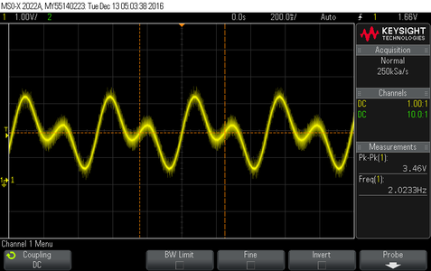

Step 5: Enjoy Testing Your Function Generator
Your function generator is all set up. Because the device only uses the sum of 8 sine waves (and optionally 8 of their negative compliments), your accuracy is pretty poor. However if you would like to use it to power an actual circuit instead of just the oscilloscope, use a buffer to power the real life circuits (to reduce the amount of noise in the signal). The pin on the FPGA cannot supply enough current to get a good waveform if you wanted to power an actual device, that's why you would need to use sort of an amplifier.
Attached are the images of the different waveforms that were obtained using our Function Generator.

As seen in the previous picture, you can tell that there are a few issues with the current setup.
The main problem is that of overflow. As seen in the earlier picture, if our sinusoid overflows, then the wave will continue from the bottom, which is to be expected. However, this obscures the waveform and is pretty annoying. The key to fixing this is to scale the wave such that it never overflows. The best solution I can think of would require detecting what the largest possible value would be and scaling the maximum value to that.
Another big issue is the DC offset. This was a little hard to notice at first, but as we add sinusoids, there seems to be an increasing DC offset that occurs. We are not sure why this happens, but we expect it has something to do with how the sum of the waves is being scaled. Another possible cause is that the sigma delta module needs feedback in order to compensate, which we didn't add.
A third improvement that could be made is adjusting the code such that it is able to handle negative amplitudes without the need for a second, unique lookup table. This could be done in a multitude of ways. The best way we could suggest would be to switch to signed binary.
The final issue is that the source file is really big because of all the lookup tables that were used. This could be fixed pretty easily by multiplexing the waves into a single lookup table. We'd recommend keeping as many copies of the lookup table as you can since it allows you to run at higher frequencies if you desire.
