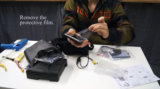

Step 4:
- Glue the foam cushions to the goggles.
- Remove the protective film.
- Assemble the fresnel lens.
- Put the housing in the support glove.
- Install the video receiver.
- Add some soft "rubber-foam" on the sides.
- Connect all the wires.
- Power up the quadcopter and look at the image in your goggles.
Parts used in video #4:
FPV goggles: http://www.hobbyking.com/hobbyking/st...
Antennas: http://rctimer.com/product-1090.html
Video receiver: http://rctimer.com/product-1129.html
