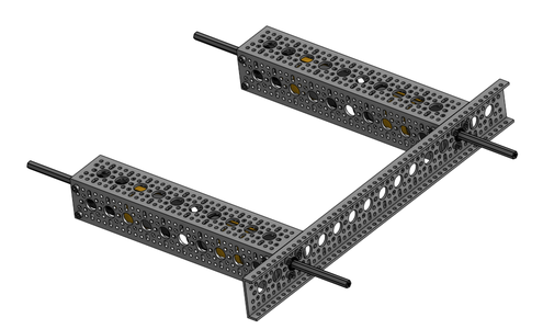

Step 1: Build Motor Channels
SUPPLIES
  1. 2 - 10-Hole U-Channel (1120-0010-0264)
  2. 4 - Yellow Jacket Planetary Gear Motor (5204-8002-0014)
  3. 4 - Quad Block Pattern Mount (1201-0043-0002)
  4. 16 - M4 x 0.7mm Zinc-Plated Socket Head Screw, 8mm Length (2800-0004-0008)
INSTRUCTIONS
First, we will build the two motor channels that will house the motors in the robot frame.
  1. Take the 10-hole U-Channel and place it on the table so that the open side is facing up.
  2. Place two motors into the U-Channel with the drive shafts pointing outwards and away from each other.
  3. Slide a Quad Block Motor mount over each of the motor drive shafts
  4. Attach each of the Quad Block Motor Mounts to the 10-hole U-Channel with 4 screws (8 screws total).
  5. DO NOT screw the motors to the Quad Block Motor Mounts yet. We will do that in the next step.
Make two of the above assemblies.

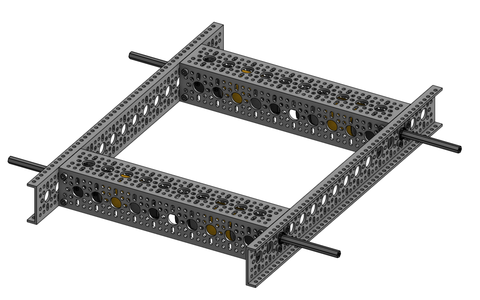

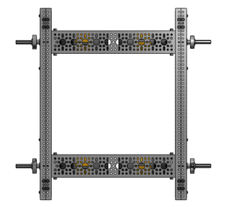

Step 2: Attach Inner Side Channels to Motor Channels
SUPPLIES
  1. Assemblies from Step 1
  2. 2 - 16-Hole Low-Side U-Channel (1121-0016-0384)
  3. 4 - Flanged Ball Bearing, 8mm REX™ ID x 14mm OD, 5mm Thickness (1611-0514-4008)
  4. 16 - M4 x 0.7mm Zinc-Plated Socket Head Screw, 12mm Length (2800-0004-0012)
INSTRUCTIONS
Using the motor assemblies, we will attach the these to the inner side-channel, using the screws on the motors themselves to hold all 4 pieces together.
  1. Slide the one Flanged Ball bearing over each motor shaft so that the flange side is closer to the motor.
  2. Take one of the Motor Channels and one of the Side Channels. Using 4 12-mm screws, attach the Motor Channel to the Side Channel so that the motor shaft is running through the third large hole of the channel.
  3. Attach the second motor subassembly to the first 16-Hole Low-Side U-Channel in a similar manner and with the motor 3 holes in from the other end.
  4. Repeat for the other side of the motor assemblies so that you form the main frame of the robot.

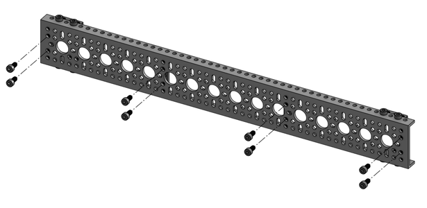

Prepare two of the 16-Hole Low-Side U-Channels.
  1. Take the 16-Hole Low-Side U-Channel and attach a total of 4 2x3 hole steel threaded plates near the end with 8mm screws as shown.
  2. The threaded plates should be screwed in through the 2rd and 4th holes from the end of the 16-Hole Low-Side U-Channel on each side and each end.
  3. Add a total of 4 1 x 5 hole steel threaded plates to the side channel with 8mm screws as shown.
  4. Make one more of these assemblies for a total of 2.
DO NOT TIGHTEN SCREWS - Leave these screws loose as it will assist in the next assembly to ensure that these screws line up with other holes. Once these two Low-Side channels are assembled to the rest of the robot frame, they can be tightened up.

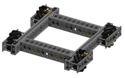

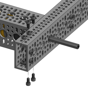

Step 4: Attach Outer Side Rail to Robot Frame
SUPPLIES
  1. Robot assembly from Step 2 and Outer Side from step 3
  2. 16 - M4 x 0.7mm Zinc-Plated Socket Head Screw, 8mm Length (2802-0004-0008)
INSTRUCTIONS
Attach the Outer Side Rails (built in Step 3) to the rest of the robot chassis by using 8mm long Cap Head Screws and attaching to the existing 2 x 3 threaded steel plates.
Tighten all screws on the 2 x 3 threaded steel plates (those just added as well as those added during Step 3. Leave the screws on the 1 x 5 threaded plates loose until the wheel shields are added at the end.

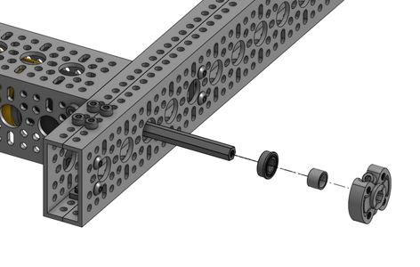

Step 5: Build Inner Wheel Hubs
SUPPLIES
  1. Robot Chassis from Step 5
  2. 4 - Flanged Ball Bearing, 8mm REX™ ID x 14mm OD, 5mm Thickness (1611-0514-4008)
  3. 4 - 8mm ID Spacer, 10mm OD, 7mm Length (1522-0010-0070)
  4. 4 - Sonic Hub (1309-0016-4008)
INSTRUCTIONS
For each of the 4 axles:
  1. Slide one flanged ball bearing over the axle and up to the Outer Side Rail hole.
  2. Slide one 7mm long 8mm spacer over the axle and up to the ball bearing.
  3. Slide one Sonic Hub (with the boss extending to the outside of the chassis) over the axle.
Press the Sonic Hub up tight to the chassis and tighten down to lock all the Inner Wheel Hub components together.

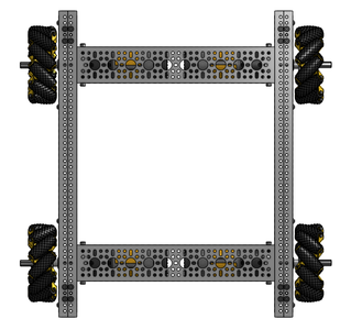

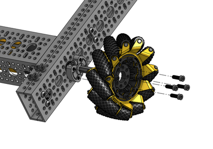

Step 6: Add the Wheels
SUPPLIES
  1. Robot Chassis from Step 6
  2. GripForce™ Mecanum Wheel Set (3625-0202-0104)
  3. 16 - M4 x 0.7mm Zinc-Plated Socket Head Screw, 12mm Length (2800-0004-0012)
INSTRUCTIONS
Attach the wheels to the sonic hubs using 4 screws each.
Ensure that the wheels form an "X-pattern" with the rollers as shown in the image

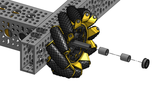

Step 7: Build Outer Wheel Hubs
SUPPLIES
  1. Robot Chassis from Step 7
  2. 8 - 8mm ID Spacer, 10mm OD, 12mm Length (1522-0010-0120)
INSTRUCTIONS
Slide two 12mm long spacers and one ball bearing onto each of the 4 axles. Ensure that the spacers go through the central hub on the GoBilda Mecanum wheels and up to the sonic hub as shown in the image.

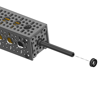

Step 8: Attach Wheel Sheilds
SUPPLIES
  1. Robot Chassis from Step 8
  2. 4 - Pattern Plate, 1 x 5 Hole (1123-0048-0144)
  3. 16 - 4mm ID Spacer, 6mm OD, 43mm Length (1502-0006-0430)
  4. 16 - Button Head Screw, M4 x 0.7mm, 55mm Length (2802-0004-0055)
INSTRUCTIONS
The wheel shields are meant to protect the wheels from getting objects caught inside them as well as to provide additional bracing for the long motor shaft sticking out of the robot.
Place the center of the 5-hole build plate over the axle and ball bearing. Using four (4) 43mm long spacers and 55mm long Button Head Screws, attach the build plate to the robot chassis. Repeat for all four wheels.
