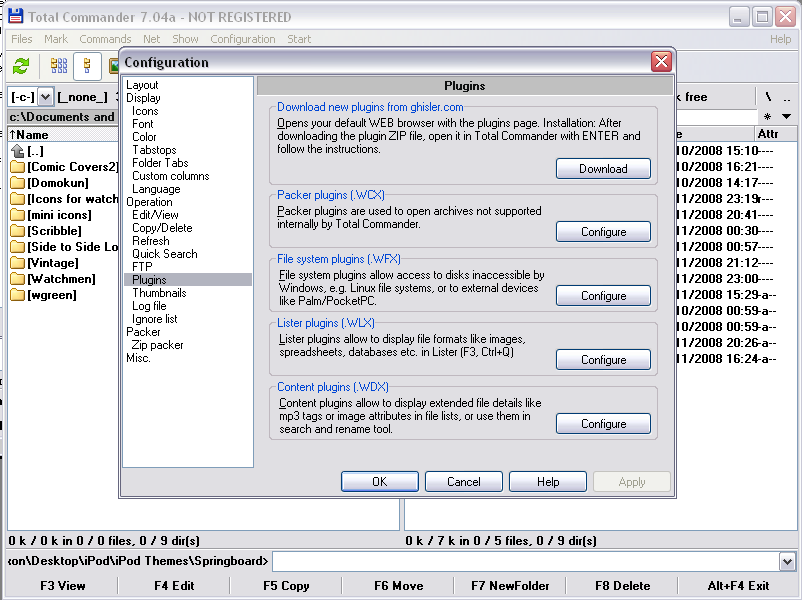

Step 2: Setting Up Total Commander
Once the files have downloaded, install total commander on your computer and save T-PoT.wfx somewhere on your hard drive.
(Pictures Correspond with steps)
1.Open Total Commander (on trial version page will come up saying you have to click a certain number to open, this is the only downside of the trial that I have found.)
2.Click Configuration
3.Click Options
4.Click Plugins
5.Click Configure under File system plugins (.WFX)
6.Click Add
7.Find your T-PoT.wfx file on your hard drive
8.Click open
9.Click OK
10.OK again
11.On the drop down menu on the LEFT select the folder where the files you want to transfer are located.
12.On the drop down menu on the RIGHT select (-/-)
13.Make sure your iPod is plugged into the computer through its USB cable and double click the (T-PoT) directory and....YOU'RE IN!
Now you can transfer files from your device to your computer and vice versa.
