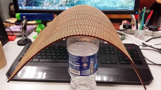

use laser cutter of choice, process the scrap piece of plywood. Align the grain of plywood to be parallel to the living hinge lines to be cut with laser cutter.
The picture describe the end process. Click on the video to see the bendable and flexible plywood.

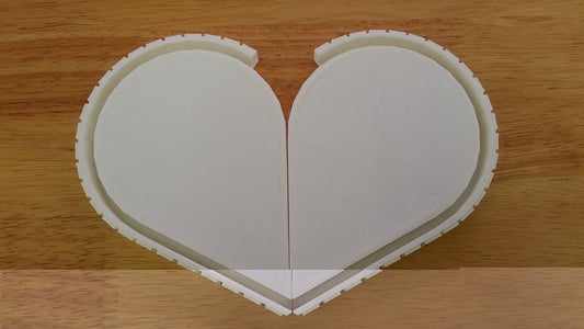

3. 3DP the sides.
judging from the above, 3DP is best; the matter of fact of yours truly cant sew, and cant cut a line straight.
It is not coincidental, the two halves of the sides are designed such that when joint together at the right angle, it forms a heart. The Beatles - And I Love Her was played mentally in his head, no he is not mad.
the 3DP sides were remixed from thingiverse:ziptop bag.

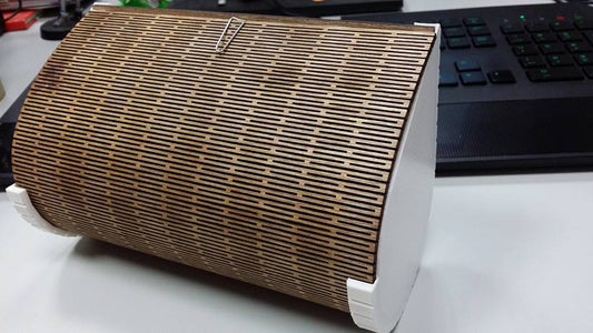

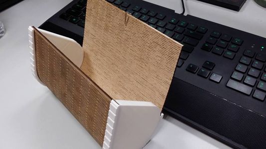

mini rare earth magnet extracted from a 2.5" hdd aeons ago, way before yours truly and missus met was sacrificed for this FabClutch. The mini rare earth magnet and a piece of Fe are set at the sides where both ends of the living hinge embrace, joining the two halves of a heart.
assembling of FabClutch is a no brainer (possibly otherwise for missus?!). slot in the laser cut hinge, close the clutch with the magnetic clasp.
