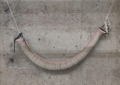

Traditional rigid formwork has distinct disadvantages for casting complex forms from concrete. Moreover, the wood formwork of a specific component can hardly be reused after disassembly. This work is based on the result of the previous fabric formwork project, with the optimization in more accuracy and controllability.

The height difference of two ends of the component will cause the position of max. curvature change, which will be later used to recognize the gravity orientation from design to fabrication. Meanwhile the length difference will determine the shape and thickness of the unit, especially the middle area.

All reasonable possibilities were collected into a catalog of units standardized in 5 cm as fabrication choices, which will also be the design space. The average curve of each unit will be used to select needed shape and compare with the fabrication result. The reason for this process is to make the fabrication more controllable and improve the fabrication efficiency.

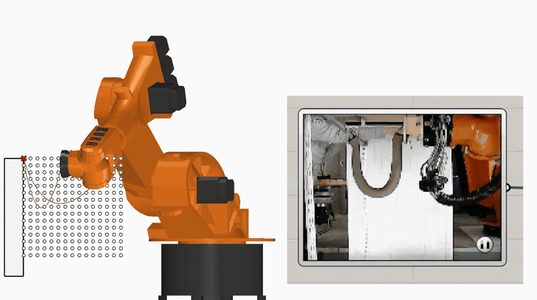

We introduced the control point of the waving curve as boid agents. The system is separated into digital and physical parts.
The digital part is used for behavioral deciding the shape to fabricate. In order to keep balance, we defined a series of behaviors of wandering and balancing. The agent will keep on moving and seeking if there are less than 4 intersection points with the lower layer, while stopping when there are 4.

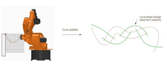

The physical part is used for controlling the fabrication process. Because of the special gravity defined shape of the units, we will never achieve exactly the same curve. The containment behavior will enable the robot to slightly adjust the shape to get closer to the design requirement. We have a seeking behavior to compare the real time shape of mid curve sensored by Webcam with the designed one. When the averaging tolerance < 2cm and the maximum tolerance < 3cm, the adjusting process will stop. The fabrication is thus finished.
Step 7: Configuration During Fabrication and Assembly
The real time shape detect takes place throughout the whole process of the fabrication and assembly. During the fabrication, it will be used to control the tolerance and to update the physical fabricating result back to the digital simulation. During the assembly, it will be used to check if the assembling position is correct and to realize the possible design changes. When design is changed by an intended different assembly from planned, the fabrication of the following component will be recalculated.
