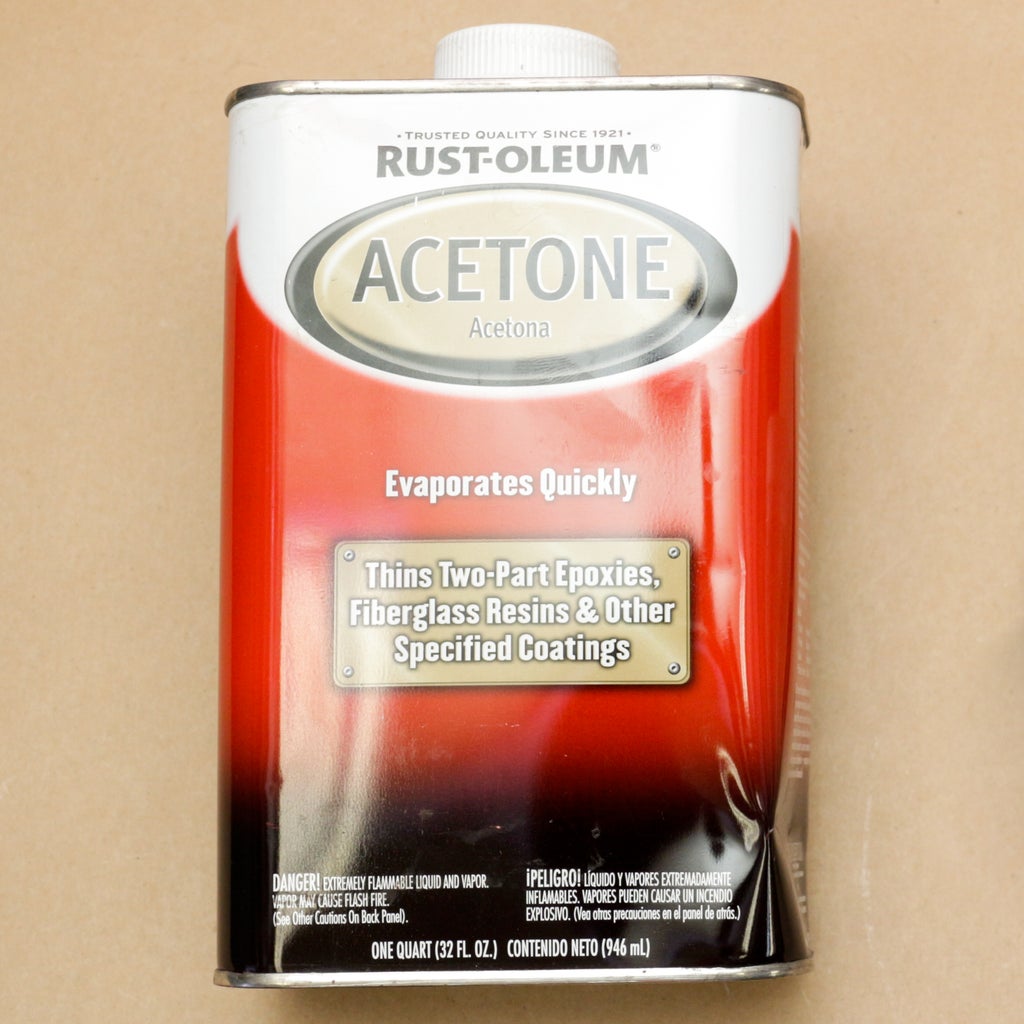

Fabric glues can be resistant to flowing across surfaces but if you need to work with a thinner glue, for a finer fabric, or a small repair, you can thin the glue with acetone. If you are going to use any solvent to thin glue, use a mixing cup and add solvent gradually until you have the desired viscosity.

The fastest way to remove fabric glue from fabric is to dissolve it with nail polish remover or any acetone-based solvent. Simply pour some on a towel and gently blot it off. Remember to always BLOT at the stain, avoid rubbing or you risk getting the stain even more stuck in your textile. When using solvents like acetone, you could potentially melt or discolor the fabric, depending on the type, so it's important to do a small patch test first.
