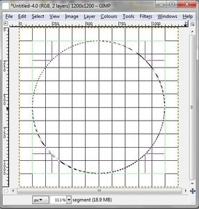

- File, Open to create a new image that is 1200 pixels square.
- Layer, New Layer and choose Transparency. Call this new layer “Segment”.
- Edit, Preferences, Default Grid and set the grid size to 100 x 100 pixels.
- View, Show Grid. View, Snap to Grid.
- Working in the layer called Segment, choose the Ellipse Select tool and click on the grid intersection that is 1 square along and 1 square up from the bottom left. Drag the cursor to make a circular selection of 1,000 pixels diameter.
- Edit, Stroke Selection, set the line width to 2 pixels, Stroke. Enter, Select, None.
Select the pencil tool and the brush to 2 or 3 pixels. Zoom to 100% and get the top half of the circle in view. Click on the centre of the circle, hold down Shift to get a straight line and click again at the top of the circle to create a radial line.

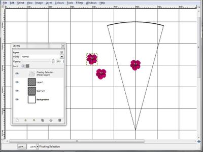

Step 5: First Layer of the Segment
Let’s get going and create a mandala segment.
Zoom in so the segment fills the screen – 100% should work. Turn off the snap to grid function (in the View menu).

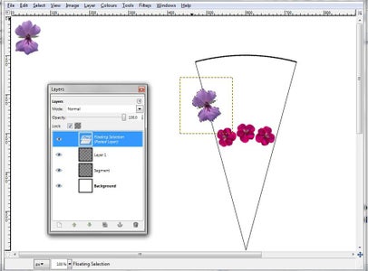

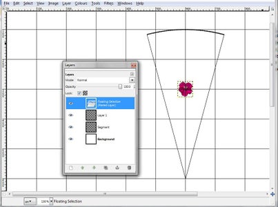

Create a new transparent layer (as in Step 3) and call it Layer 1. Work in that layer, but with the white background layer and Segment both visible. File, Open to open a suitable image (one of the two fuchsia florets, in the example) and then select the whole of the layer containing the image but not the background. Edit, Copy. Paste it into Layer 1 (Edit, Paste) but don’t anchor it yet. Resize it to something suitable using the Scale tool, remembering to link width and height in the dialogue box to keep the proportions right. Position it somewhere in the middle of the segment, on the vertical centre line. Before you anchor it using Layer, Anchor Layer, copy it (Control-C) and past a couple of copies (Control-V) onto the canvas but outside of the segment. Doing that will have the effect of anchoring the first and second images. Drag the third image off the second one so you can see it.

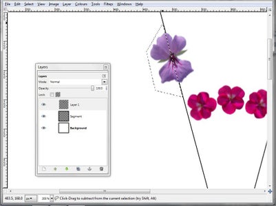

Rotate that image while it is un-anchored (using Tools, Transform Tools, Rotate) and position it on an imaginary arc that is the same distance from the point as the first image, but to one side. You can allow it to overlap the first image if you wish. Anchor it when it is where you want it.
Use the Rectangular Selection tool to select the remaining copy, then rotate it by a different amount and use the Move tool to position it on the other side. It should be more or less on the same imaginary arc, but don’t be too precise, a bit of variation adds to the effect. Turning off the visible grid may help. When you are happy with the position, anchor it.
Put some different elements (ie not fuchsia florets, or at least, not the same fuchsia floret image) into the same layer, smaller ones near to the point and larger ones towards the arc. Allow some to touch the sides, or overlap half way. When you have an image that overlaps, you’ll need to get rid of the portion of it that is outside the segment. Do that by zooming in and using the Free Select tool to select a polygon around the area to be removed, then use the Eraser tool to rub it out. Select, None to de-select when you have finished.
Finally I put several copies of one of the rosequartz images into this layer too, near the point.

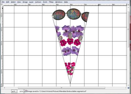

Create another new transparent layer called Layer 2. Keep the other layers visible while adding extra images into this new layer, to fill in some of the gaps. Use some of the images that haven’t already been used in Layer 1 but you can reuse maybe one or two of the Layer 1 images as well as long as they are resized, flipped or rotated to provide variety.

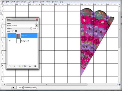

Create another 2 layers and fill them with images. It helps to change the order of Layers 1-4 in the stack from time to time as you work, to get a feel for how it could look when finished. Leave a few gaps between the images, tiny ones near the point and larger ones towards the arc.
When you have all the layers done, experiment with changing their order until you find which looks best, then merge all the layers down except for the white background layer. (Layer, Merge Down).
