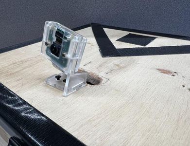

Step 4: Mounting the PiCam
First, we made a hole on the top of the box to allow the camera to connect to the Raspberry Pi inside the box. We did this by drilling holes into the top portion of the box, typically with a 0.25 inch drill bit. We made 4 holes touching each other side to side, and then connected them into an oval by chipping away the awkward wooden pieces in the middle .
To mount the Raspberry Pi cam, we had to first place the Pi cam into the camera holder. This was quite a challenging step because of the required order of operations. More than one set of hands is recommended.
We then placed the camera holder on the top of the box right in front of the oval hole we made earlier. We used 0.2 mm wood screws to secure it onto the box. We then let the camera cable into the oval hole.
