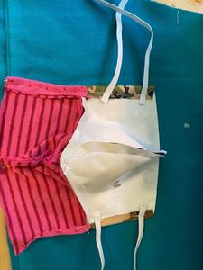

Step 1: Face Mask

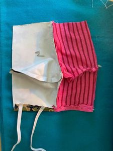

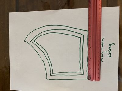

Create a pattern and cut out the approximate size . It’s best to make it a little big. Cut out two pieces each of the 2 fabrics.

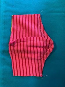

Sew the 2 sets of pieces together, right sides together along the curved edge.
Open out and put the lining and front pieces together right sides together.
Sew the tops of these pieces .
Open out. Turn under the side edges and sew.

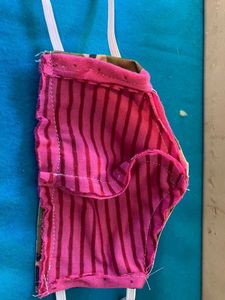

Add two pieces of elastic to both sides. If elastic is unavailable you can use the polar fleece fabric insead.
Sew the bottom edge.
Turn right side out.
Edge stitch top and bottom.
Feed filter or surgical mask through the channel.
