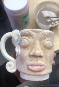

- I pressed my finger where the eyes were to create little dents to mimic eye holes (you can see that dent on the third picture).
- Then I created tiny ovals that I slipped onto the hole as eyeballs.
- Then I rolled some clay flat, cut it (curved the direction of the cut depending on whether is was the upper or bottom eyelid).
- Then I placed them onto top of the iris and blended the edges into the face as shown in the picture.

After creating the basic shapes, blend the edges to the mugs and begin the process of adjusting. Adjust things out in areas where you think they should be blended or add creases where it looks right. If any part doesn't look right, it's okay to scratch it all and start over. I myself started each of the features more than once.

For example, I made the lips open because I liked that part in a picture of a model I found online and for the nose, I modeled it after my own. The eyes I just tried my best to make them look like actual eyes because of how tricky they are.
Once you get a face you like, you can add the handle to the mug, and then continue to add any additional details.
