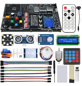

  • RaspberryPi with the Freenove Project Kit

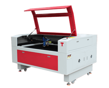

Step 2: Laser-Cut
For this step, you will need to laser-cut the plywood pieces using the provided files. Each file corresponds to one of the plywood sheets, and they have been designed to fit the dimensions of 600 mm x 450 mm x 5 mm.
  1. Prepare the Laser Cutter: Ensure that the laser cutter is properly set up and calibrated. Make sure that the cutting bed is clean and free from any debris.
  2. Load the Files: Upload the provided files into the laser cutting software.
  3. Secure the Plywood: Place one plywood sheet onto the laser cutter bed, ensuring it is aligned correctly and securely held in place. Repeat this step for the second sheet after the first one is cut.
  4. Adjust Settings: Configure the laser cutter settings according to the material specifications. Use the appropriate power, speed, and frequency settings to achieve clean cuts without burning or charring the wood.
  5. Start Cutting: Begin the cutting process for the first file. Monitor the process to ensure that the cuts are clean and accurate. Once completed, remove the cut piece and load the second plywood sheet to cut using the second file.
  6. Inspect the Cuts: After both pieces are cut, inspect the edges and surfaces to ensure they meet the project requirements. Clean any residue or debris from the cut edges if necessary.
These steps will help you achieve precise and clean laser cuts for your project components.

Step 7: Connect Your RaspberryPi
Now we will connect the raspberr pi with the freenove project kit and our PC:
  1. Connect the raspi to the freenove project kit. If you have trouble with this, please look at the freenove project kit documentation
  2. Connect the Raspi to a power source (included with the Raspi)
  3. Connect the Raspi to your PC with an ethernet cable (included with the Raspi)
Step 8: Setup and Connect Your Project Kit
In this step, you will connect the servo motor and LCD to the project kit, and then connect the camera to the PC.
  • Place the Project Kit Inside the Box:
  • Carefully place the project kit inside the box, ensuring that it fits well and is stable.
  • Connect the Servo Motor to the Project Kit:
  • Locate the servo motor connection pins on the project kit.
  • Connect the servo motor’s wires to the corresponding ports on the project kit. Ensure that the connections are secure and correctly aligned.
  • Connect the LCD to the Project Kit:
  • Find the LCD connection pins on the project kit.
  • Connect the LCD screen’s cables to the appropriate ports on the project kit. Make sure the cables are securely attached.
