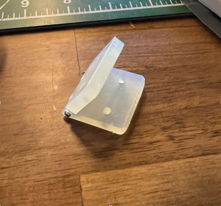

Step 2: 3d Print the Hinges, Brackets, and Other Parts
It is totally doable to build a strong box without using angle brackets. here's a link of an Instructable which only used wood and wood glue to build a box.
We used screws (m4) instead as we wanted to make sure that we could assemble and disassemble the box in case we needed to repair things on the inside.
If you also decide that you want to assemble your box with screws and bracket instead of fingers, here are the 3d prints of the angle brackets and other pieces we made (door handle, lock, hinges).

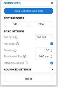

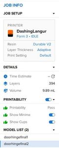

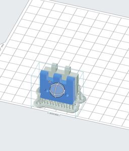

The door hinges and angle brackets are SLA printed on the Forms Labs SLA printer out of durable resin and tough 1500 resin respectively. The other parts are printed out of MatterHackers Quantum PLA on the PRUSA Mini+ 3D Printer.
Import the hinges and angle bracket CAD files on the SLA print software and position them such that the supports are touching. Make sure to choose the correct material for each (durable - door hinge and tough 1500 - angle brackets).

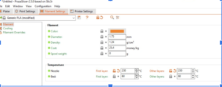

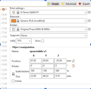

Import the door handle, locking mechanism, and servo plates onto PRUSA slicer and switch the material to Prusament PLA.
Note: The angle brackets are NOT identical.
